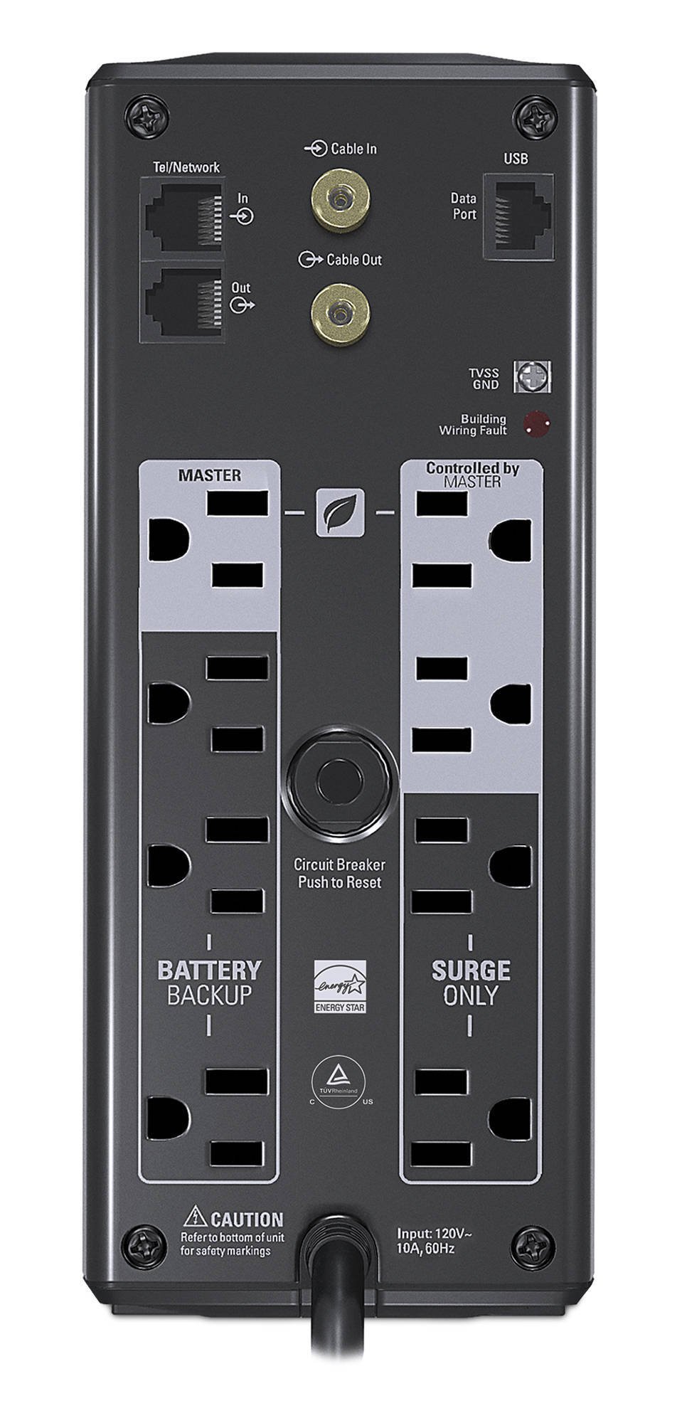

I installed a UPS (APC-NS1080G) and now noticed drops on eth0 received is that possible? it is a USB cabled device so not sure if it is responsible or not I have had to reinstall windows after the update screwed up several app drivers I also tried to install calibre but ran into a problem trying to install the script to the docker so I removed it and its appdata wondering if there are remnants of that causing the issue, any takers on where the problem might lie?

From your log:
Nov  1 14:36:02 homeNAS apcupsd[10300]: Power failure.
Nov  1 14:36:03 homeNAS dhcpcd[1757]: eth0: carrier lost
Nov  1 14:36:03 homeNAS kernel: e1000e: eth0 NIC Link is Down
Nov  1 14:36:03 homeNAS avahi-daemon[10333]: Withdrawing address record for 192.168.1.152 on eth0.
Nov  1 14:36:03 homeNAS avahi-daemon[10333]: Leaving mDNS multicast group on interface eth0.IPv4 with address 192.168.1.152.
Nov  1 14:36:03 homeNAS dhcpcd[1757]: eth0: deleting route to 192.168.1.0/24
Nov  1 14:36:03 homeNAS avahi-daemon[10333]: Interface eth0.IPv4 no longer relevant for mDNS.
Nov  1 14:36:03 homeNAS dhcpcd[1757]: eth0: deleting default route via 192.168.1.1
Nov  1 14:36:04 homeNAS ntpd[1815]: Deleting interface #2 eth0, 192.168.1.152#123, interface stats: received=133, sent=133, dropped=0, active_time=69257 secs
Nov  1 14:36:04 homeNAS ntpd[1815]: 74.82.59.150 local addr 192.168.1.152 -> <null>
Nov  1 14:36:08 homeNAS apcupsd[10300]: Running on UPS batteries.
Nov  1 14:36:08 homeNAS sSMTP[4877]: Unable to locate smtp.gmail.com
Nov  1 14:36:08 homeNAS sSMTP[4877]: Cannot open smtp.gmail.com:465
Nov  1 14:36:19 homeNAS apcupsd[10300]: Mains returned. No longer on UPS batteries.
Nov  1 14:36:19 homeNAS apcupsd[10300]: Power is back. UPS running on mains.
Nov  1 14:36:19 homeNAS sSMTP[5206]: Unable to locate smtp.gmail.com
Nov  1 14:36:19 homeNAS sSMTP[5206]: Cannot open smtp.gmail.com:465
Nov  1 14:36:25 homeNAS dhcpcd[1757]: eth0: carrier acquired
Nov  1 14:36:25 homeNAS kernel: e1000e: eth0 NIC Link is Up 1000 Mbps Full Duplex, Flow Control: Rx/Tx
Nov  1 14:36:26 homeNAS dhcpcd[1757]: eth0: rebinding lease of 192.168.1.152
Nov  1 14:36:31 homeNAS dhcpcd[1757]: eth0: probing for an IPv4LL address
Nov  1 14:36:31 homeNAS dhcpcd[1757]: eth0: DHCP lease expired
Nov  1 14:36:31 homeNAS dhcpcd[1757]: eth0: soliciting a DHCP lease
Nov  1 14:36:37 homeNAS dhcpcd[1757]: eth0: using IPv4LL address 169.254.251.87
Nov  1 14:36:37 homeNAS avahi-daemon[10333]: Joining mDNS multicast group on interface eth0.IPv4 with address 169.254.251.87.
Nov  1 14:36:37 homeNAS dhcpcd[1757]: eth0: adding route to 169.254.0.0/16
Nov  1 14:36:37 homeNAS avahi-daemon[10333]: New relevant interface eth0.IPv4 for mDNS.
Nov  1 14:36:37 homeNAS avahi-daemon[10333]: Registering new address record for 169.254.251.87 on eth0.IPv4.
Nov  1 14:36:37 homeNAS dhcpcd[1757]: eth0: removing route to 169.254.0.0/16
Nov  1 14:36:38 homeNAS ntpd[1815]: Listen normally on 3 eth0 169.254.251.87:123
Nov  1 14:36:38 homeNAS ntpd[1815]: new interface(s) found: waking up resolver
Do you happen to have your Ethernet switch plugged into the 'Surge' only plug on the new UPS?  After your UPS went on battery your Ethernet went dead.  If power fails, or in the case of what looks like your plug-pull UPS test, the surge only outlets go dead.  Also, whatever is plugged into the 'Master' outlet when turned off or goes to sleep/standby it will cause the two gray surge-only  'controlled by master' outlets to turn off as well.  Another tidbit is to not plug in your gigabit Ethernet cable to the data protection ports.  The ports are only rated for 10/100 connections.
Thank you for the input and yes you are correct the router power brick was incorrectly installed on the surge protection side I have installed the ethernet directly into the router so far so good no drops, Do you know of any known issues running the coax into this unit I did because it was there? Thanks again that was what I was looking for! And that first power outage happen to be the real deal I did not do that so guess the investment has already showed some dividends between the utility company and my kids popping breakers this thing will serve me well!

Those UPS coax protections are typically not good for anything beyond analog antenna which is of no use these days.  The lightning protection typically consists of a poorly implemented gas discharge tube device and on most if not all consumer grade surge protectors/UPS they are typically not impedance matched for 75 ohm use and the higher frequencies involved with digital OTA, cable TV/Internet, and Satellite will suffer from signal reflections.  In the US it is NEC requirement for coax to be grounded at or near the service entrance for cable/satellite and antenna (as it requires a rather large ground wire, typically 10AWG or larger).  So if done right you should already be covered for outer conductor protection.  Inner conductor protection suggest a high quality lightning surge protector rated for 1GHz with low insertion and return loss such as Tii Technologies 212FF75F225-21 (here, here) or if you can find it, Extreme Broadband Engineering BB1SP.

Wow good info I just switched from cable (comcast) to fibre (verizon) but I'll have to look now that you brought that to my attention as it's only fibre to the control panel
