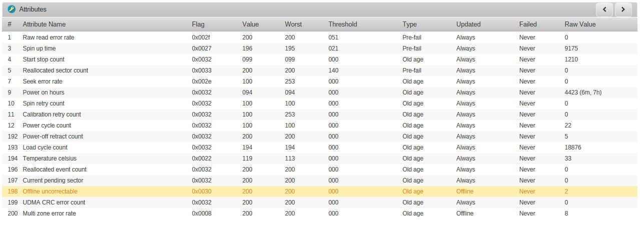

Parity might be failing?
I just noticed this today.  Should I be concerned about this error and replace the drive, or is this not something to worry about?
It's never a good sign but check if it passes an extended SMART test.
Here is the result of the extended SMART test.  It says the overall test passed but it also shows
Num  Test_Description    Status                  Remaining  LifeTime(hours)  LBA_of_first_error
# 1  Extended offline    Completed: read failure       60%      4427         842782376
The parity that is failing is a 6TB where all the other drives in my array are 2 and 4TB. not sure if it is less concern for failing sectors considering there is lots of room to rewrite the data in another sector. Or am I wrong? I bought the drive only a couple months ago, but it was in an external enclosure that i broke open so no warranty.
That doesn't mean anything in this case, just that the SMART attributes are within limits.
This is the the result of the extended test, and it failed with a read error.
That's not how it works, that LBA is before the 4TB mark, so if another disk fails and you need to rebuild it there will read error(s) resulting in a corrupt rebuild.
You could try preclearing the disk (or re-syncing parity) since sectors are only remapped on writes, and then run another extended test to confirm if it's now good, but I personally would just replace it.
Thanks for the advice johnnie.black. I did a pre clear and am about to re-sync parity. but regardless I think im going to order up a new drive like you said just because its not worth the chance of failure.
