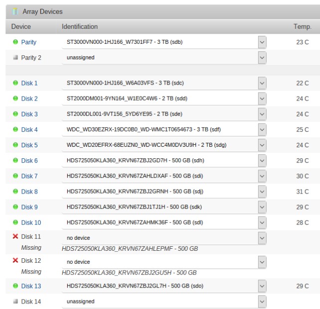

Drop Disk
Mother board Dell t3400
6 Disk on Mother Board sata
8 Disk on sas2lp-mv8
What to do next ?

ygortower02-diagnostics-20171109-0958.zip
Power cycling should get both missing disks online, then post new diags as current one is missing SMART from both since they are offline.
Both disks look healthy, most likely the typical SAS2LP problem, you were lucky none of the disks got disable, SASLP and SAS2LP are no longer recommended for unRAID v6, if you can replace it with an LSI HBA, like the 9201-8i, 9211-8i and clones.
