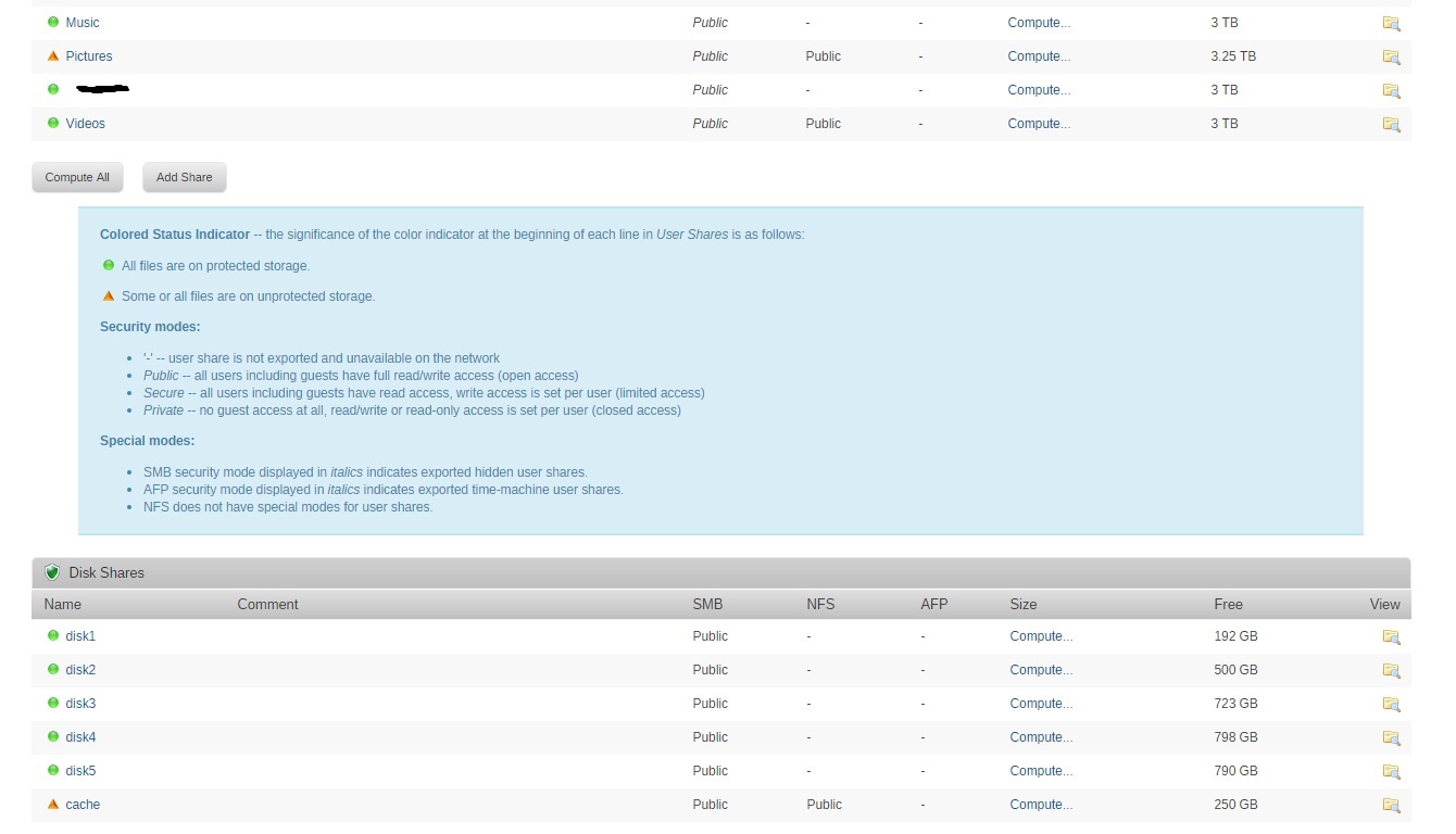

While doing a routine check of the system, I noticed a shared drive and the cache drive both had an orange triangle instead of the Happy Green I like to see.
The attached screenshots show everything I'm seeing. The share says that some or all of the files are on unprotected storage.
The cache drive says that the drive is mounted, underlying device does not have redundancy.

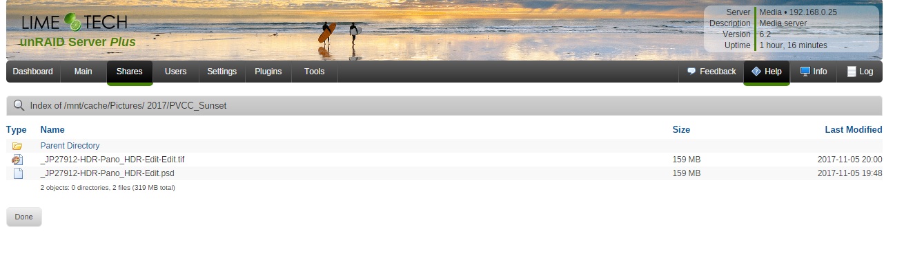

On the cache drive is a Pictures folder with an empty 2016 sub-folder and a 2017 sub-folder with another sub-folder.
In that last sub-folder are two pictures, one being a .tif file and the other being a photoshop .psd file.
Both pictures are about 159MB.

Cache is unprotected because it's a single device, not a pool, Pictures share is unprotected because one or more files reside on the unprotected cache device, make sure that use cache for that share is set to "yes", run the mover and it will turn green.
Ugh! Thanks johnnie.black! As read your response, I'm thinking duh, I know that. How easy we forget.
 I had lost power, the server was very slow to boot up, then with the other things I described, I immediately though the worst.
I ran the mover and Poof,..all Happy Green again.
