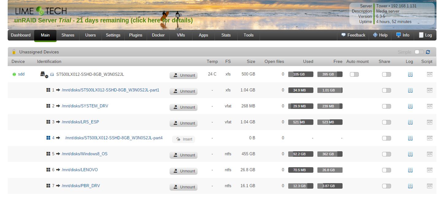

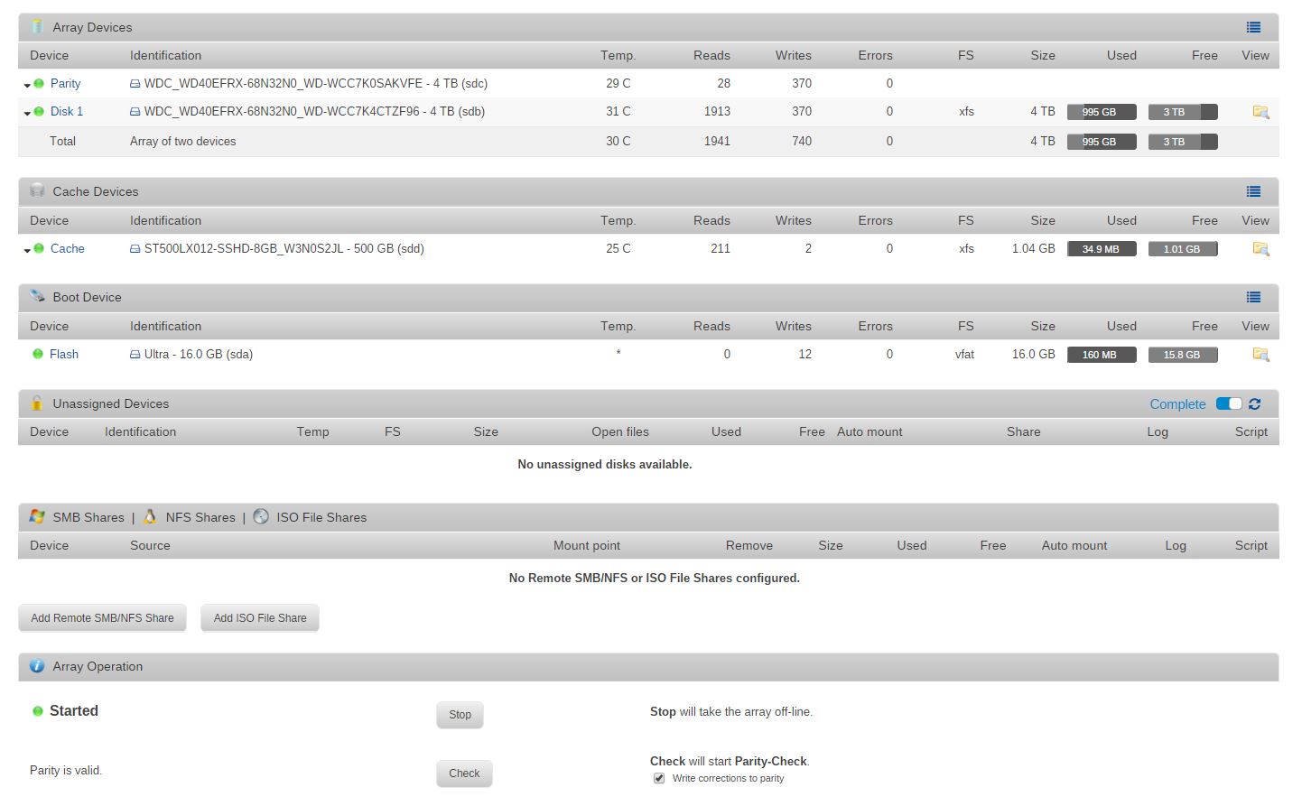

Thanks for that. I managed to mount, format and assign the disk as a Cache drive. However, it came up as only 1.04Gb.

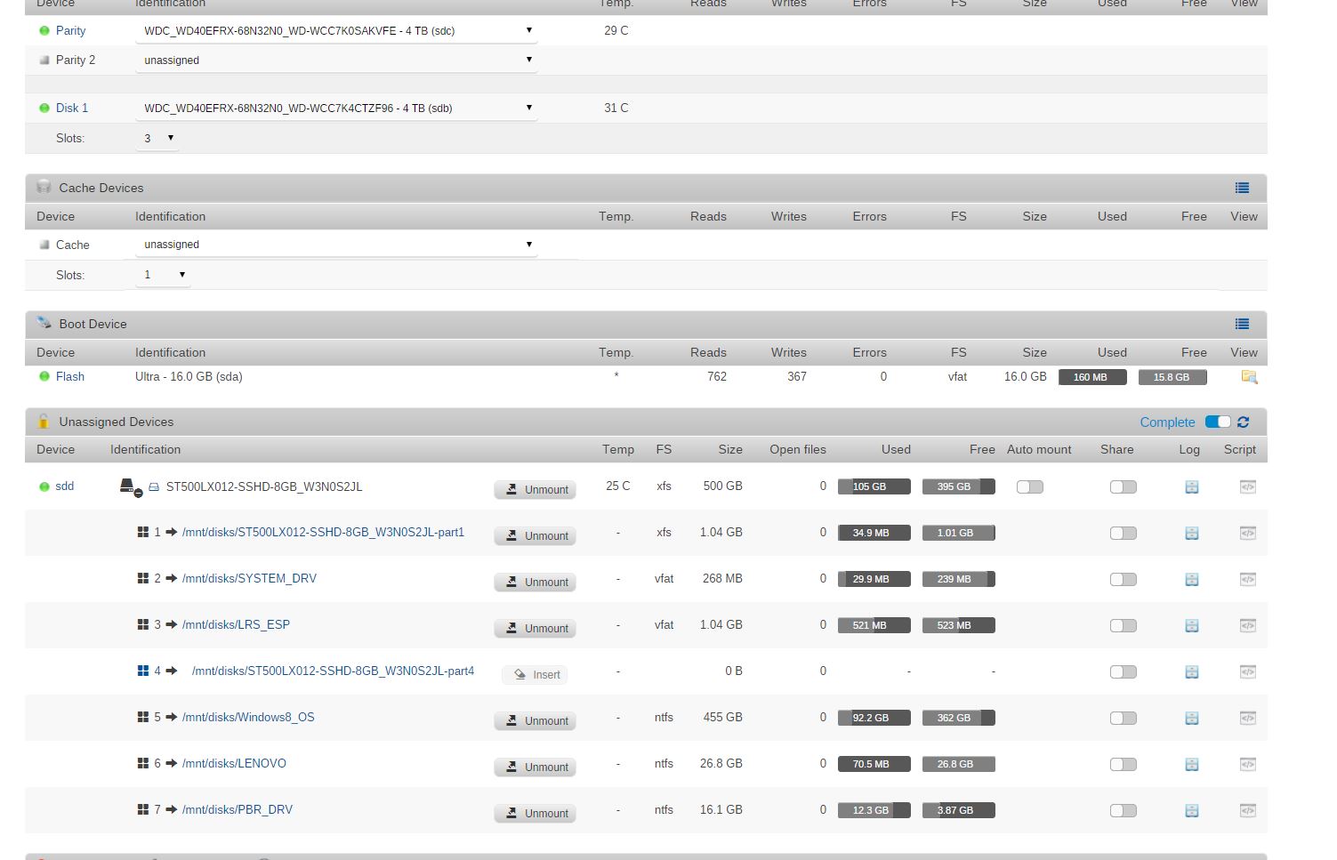

I have unassigned it again so that I can have a look at the partitions (as shown below) and unmounted them all.
Have tried reformatting to BTRFS and back to ZFS but it always ends up as picking up just the 1.04Gb partition as shown below.

Unassigned it, delete all existing partitions using the UD plugin, and then re-assign and re-format.

I can see the partitions in UD but I cannot see any way to actually delete them??
What do I actually do in UD to delete an existing partition?
Go to settings -> unassigned devices and enable destructive mode, you'll than see a red x next to each partition (they need to be unmounted first)
