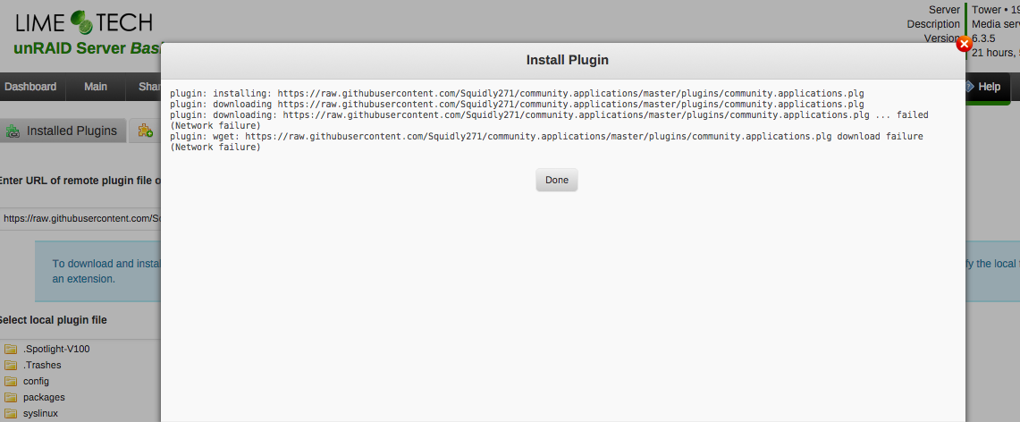

However, it still will not let me instal the CA plugin.  Its giving me an error every time.  The one I had is uninstalled as well.  I used the link from you main CA thread, and pasted in the plugin install spot and tried to install it.  But its a no-go. I did 'check for updates' prior to trying to install it.  Any ideas?
post the contents of the pop up that appeared

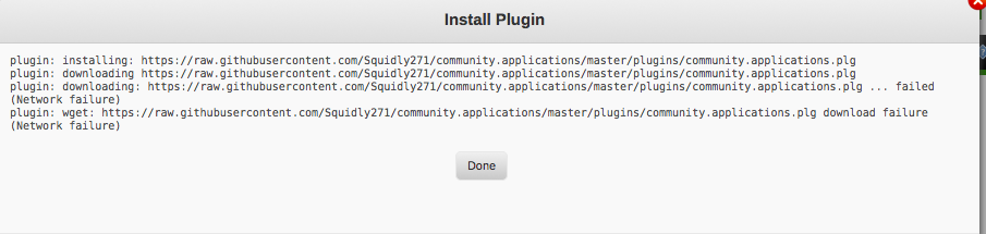

I used the following link, and got this error.  Thanks again for your help.
https://raw.githubusercontent.com/Squidly271/community.applications/master/plugins/community.applications.plg

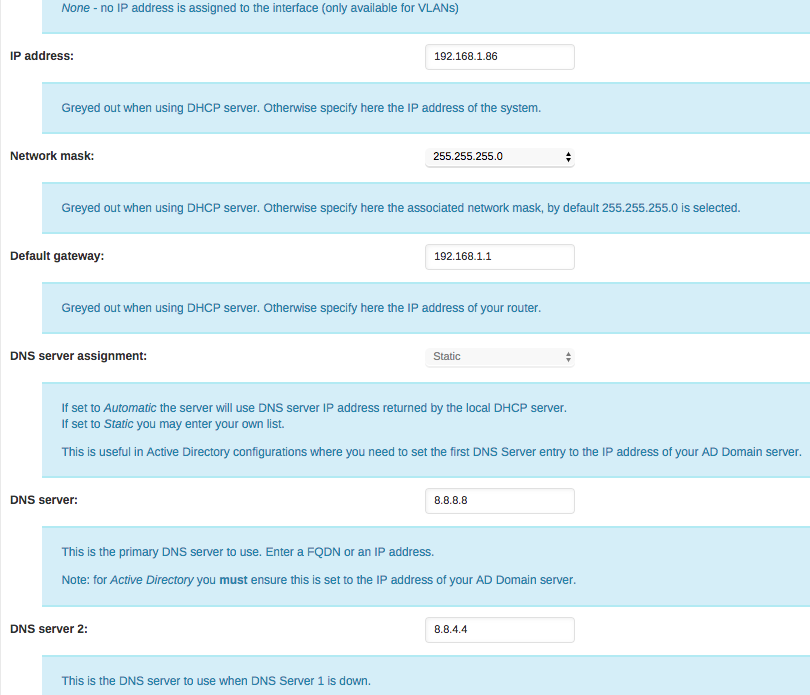

Most common cause is for whatever reason system can't resolve the URL.  Try Settings - Network settings and manual set DNS addresses to 8.8.8.8 and 8.8.4.4
This is weird.  I did that, and it's still not working.  Everything else on the server seems to be working, even the VMs.
Got it!  Had to change my gateway to 192.168.1.254.   I've switched from Comcrap to AT&T Fiber a couple weeks ago, and didn't think that I would need to change it here, and its the last thing I thought of when trouble shooting this issue.
