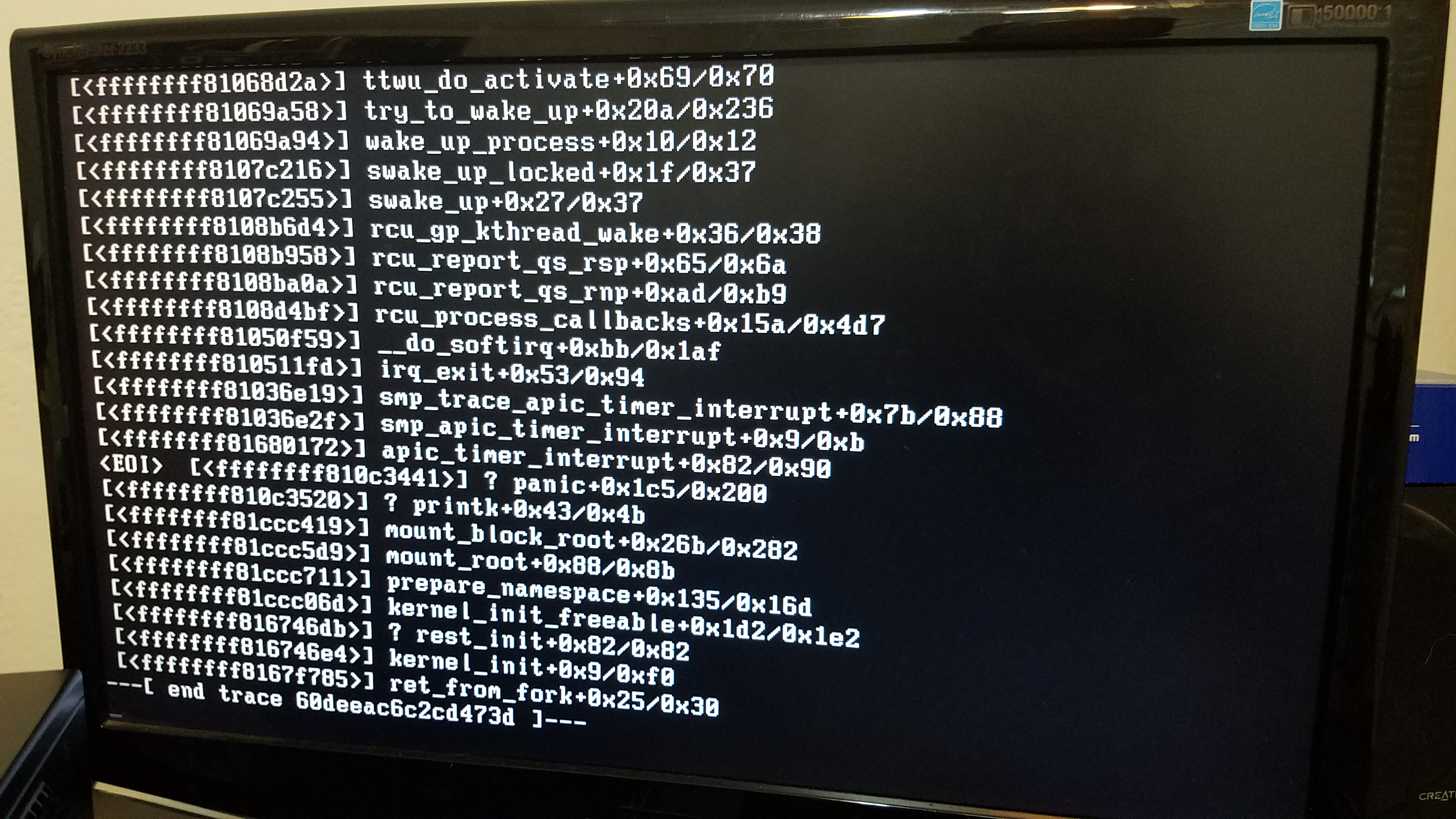

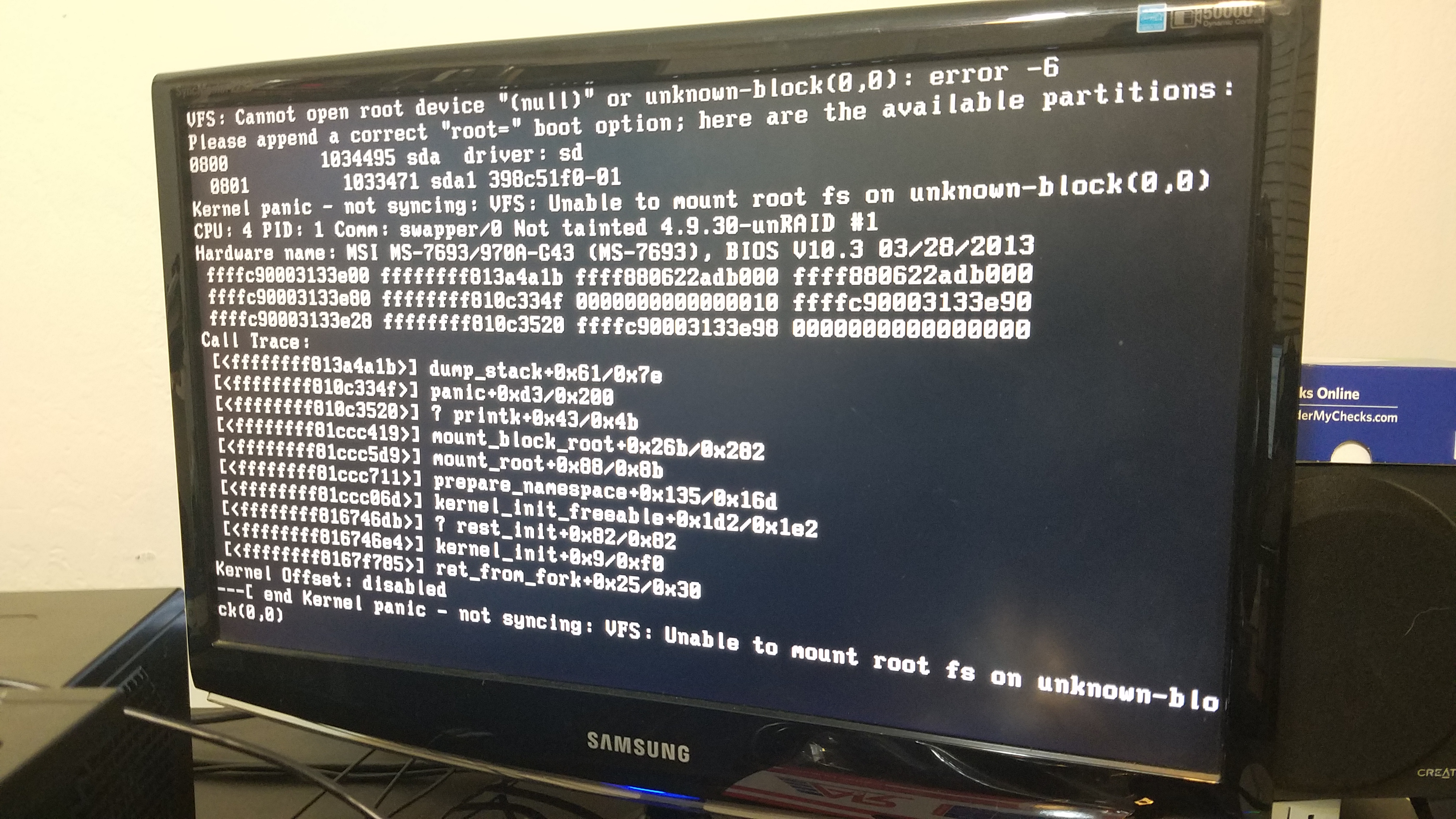

- I then found other topics in the Lime forums stating that the usb stick could be corrupted. I removed the usb stick, put it into my windows laptop, and it's all there. I'm able to view the files just fine....and none of the system files or boot files have been changed since May of this year when the system was originally brought online. I've attached an image of both of the error screens I'm getting - I think they're basically the same error though. From my 'research' I think it's not recognizing the usb boot files.

Use a different flash drive and create a new trial installation just to see if it boots.
Ok i installed 6.3.5 onto a new flash device and it worked. I can get into the unraid gui, and i can follow unraids instructions for registering a new key. I can access all my files on the old usb key, is there any way to use them to reduce the amount of work i need to do getting my system back the way it was?
You can try redoing your original flash, only thing you need to copy is the config folder, or if you prefer to transfer the license to the new flash drive again just copy the config folder from the old one.
Ok i will definitely try that and report back. So did i cause this by changing my system ram configuration? Or is it likely caused by an addon or a random failure of my usb key?
Likely cause by corruption or failure of your flash drive.
