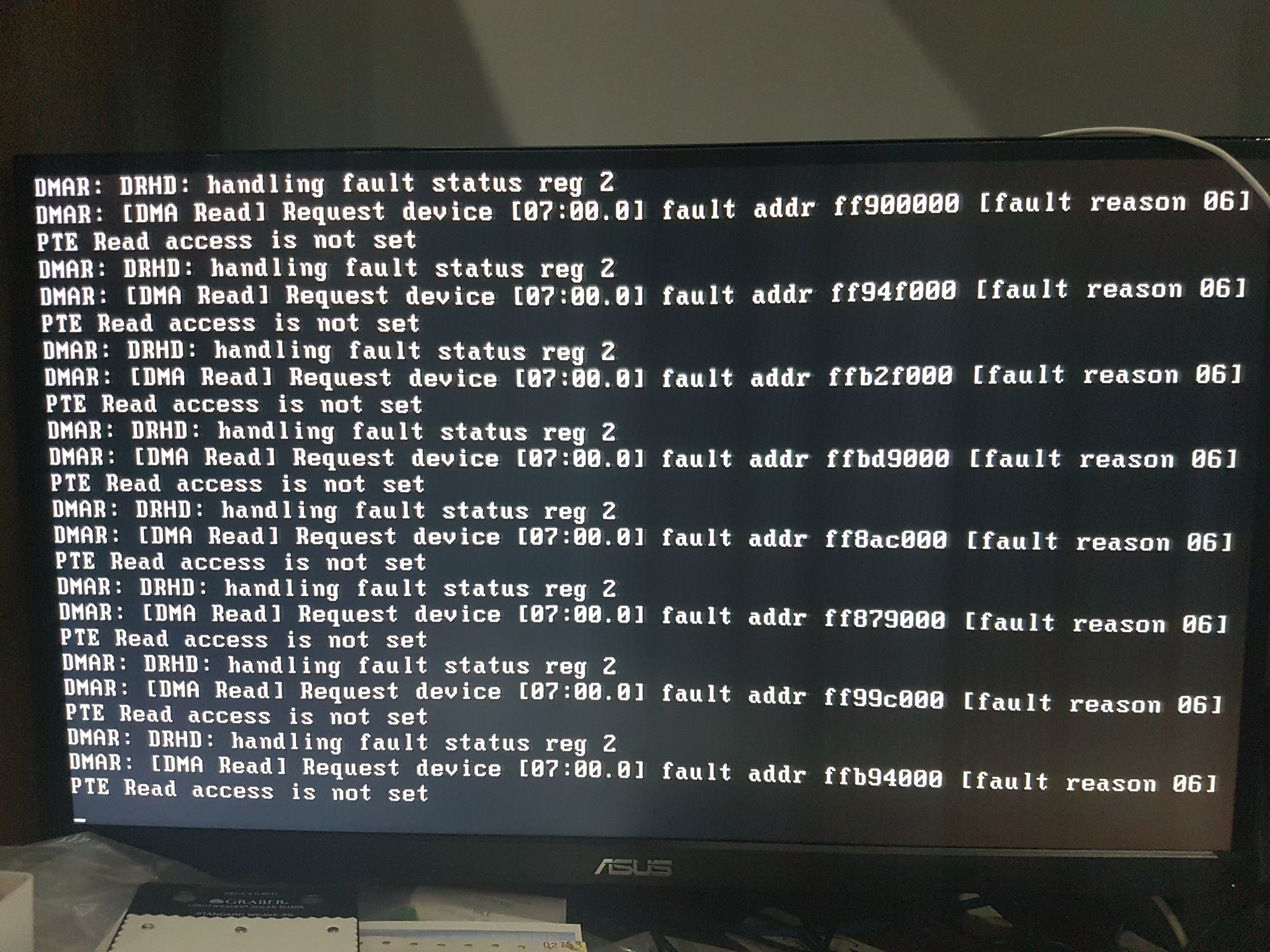

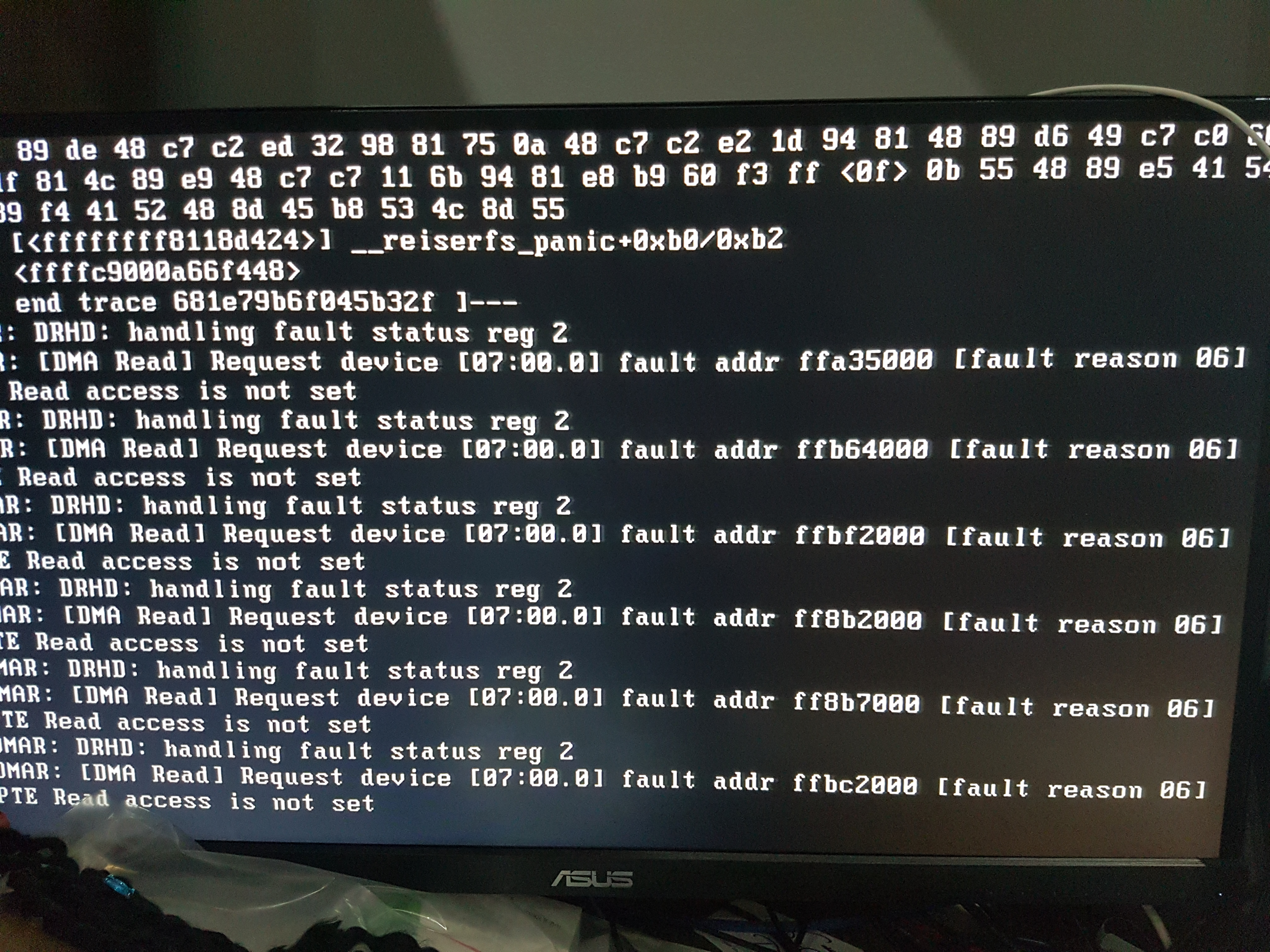

DMAR: DRHD: handling fault status reg 2
DMAR: [DMA Read] Request device [07:00.0] fault addr ff8b7000 [fault reason 06]
PTE Read access is not set

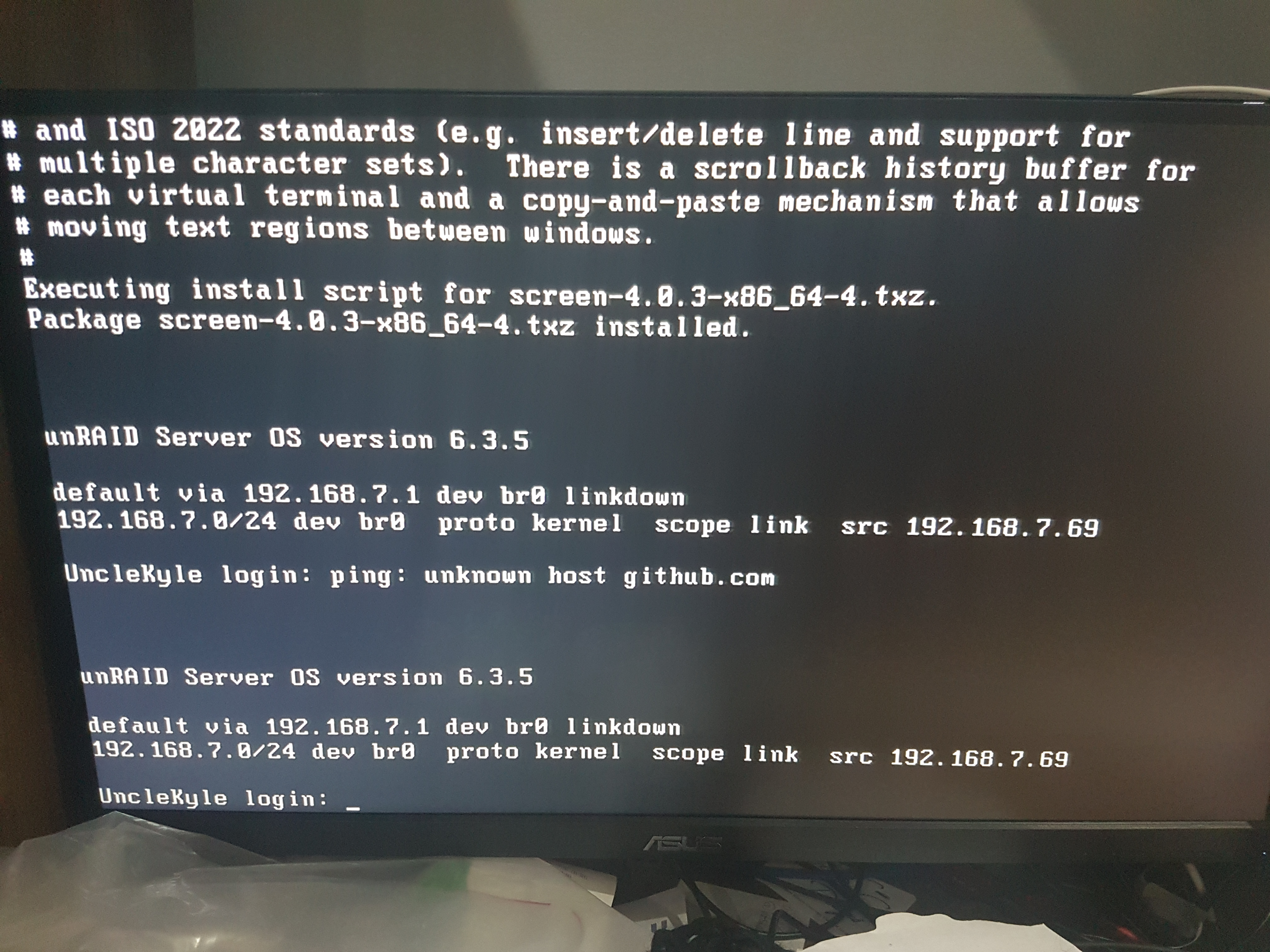

Can you still get the diagnostics on the console when it crashes? Without them it's difficult to help.
The system crashes within minutes of powering on. I can try
