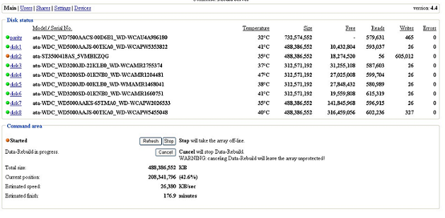

At your behest I swapped no disks. I followed your earlier instructions but when I got to the part about re-assigning the disk2 back to itself I stopped. That drive is really in bad shape and thought I would get more advice before proceeding. I have attached some screen caps to help things out.
I did add a new disk to the system but left it unassigned as I wanted more advice on the best way to go about this, it is the same size as the one that died (500 gigs) but is smaller than the parity drive (720 gigs).
screencap.zip
Here is the other screen cap. I will assign the new unassigned disk as disk 2 and hope it rebuilds.

Yippppppeeeeeeee
It looks like replacing the drive caused a rebuild to start.
Once this rebuild is done, I expect to
1. upgrade to the latest version.
2. remove the old dead drive and see if it is still under mfgr warranty
3. add a new 1tb drive and follow the procedure for making that the parity drive.
Do you know the "device" name of the drive you added?  (I guess I can try to deduce it from the last syslog, but it would save me a few minutes)
Your screen caps did not get attached.  Perhaps you can try again with them.
If you did not un-assign disk2, this would be the time to do it on the devices page.  That should take the defective disk out of the picture.   See if the array will then "Start"
Again, don't do anything but press "Start" at this point.
I'd like to see the screen-shot before proceeding so I can see what you are seeing.
Joe L.
You are a bit ahead of me, but great news that a rebuild is in progress.
Can you see the files on it from your file-explorer in windows?
Post a syslog, now, before it completes the re-construction.  It will give me an idea of what is happening.
Joe L.

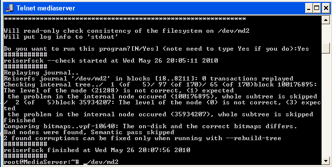

Looking at the old screen shot, it seems to indicate that disk2 is unformatted.  Does it still say that?
DO NOT PRESS THE FORMAT BUTTON.  DO NOT PRESS THE FORMAT BUTTON.
Let me repeat
To unRAID, it just indicates the drive could not be mounted.  (and any drive it cannot mount it thinks is unformatted)
Just post a syslog.  We may need to do a file-system repair for it to mount, but I won't know until you answer some of the previous questions.

attached is a screen cap of the progress. Syslog coming soon.
That screen cap looks wonderful....
I can see that disk2 did get mounted, and that the re-construction is under way.  And there is no "Format" button, since there are no disks it thinks are unformatted. (So you can't press it)
Now...  Do not allow the server to lose power until the disk is re-constructed.
Joe L.
(I realize it is not as easy to keep the power coming into your home, but we want the process to complete without interruption)
Based on the latest syslog, you are not out of the woods just yet.
It shows the file-system on disk2 needs repair.
May 26 15:59:49 MediaServer kernel: ReiserFS: warning: is_tree_node: node level 0 does not match to the expected one 3
May 26 15:59:49 MediaServer kernel: ReiserFS: md2: warning: vs-5150: search_by_key: invalid format found in block 35934207. Fsck?
May 26 15:59:49 MediaServer kernel: ReiserFS: md2: warning: vs-13070: reiserfs_read_locked_inode: i/o failure occurred trying to find stat data of [900 958 0x0 SD]
May 26 15:59:49 MediaServer kernel: ReiserFS: md2: warning: vs-13070: reiserfs_read_locked_inode: i/o failure occurred trying to find stat data of [900 909 0x0 SD]
Let the re-construction complete.  At that point, we'll perform the file-system repair.  We can't really do that until the re-construction is finished (or rather, I prefer to wait until it is complete)
Joe L.
You'll need to follow the procedure as described here in the wiki:
http://lime-technology.com/wiki/index.php?title=Check_Disk_Filesystems
You'll be operating on /dev/md2
so use the appropriate commands for that disk.

I ran the check... It said I must run a --rebuild-tree (see pic) the instructions you posted for me to read said NOT to run it until I talked to poeple on the forum.
