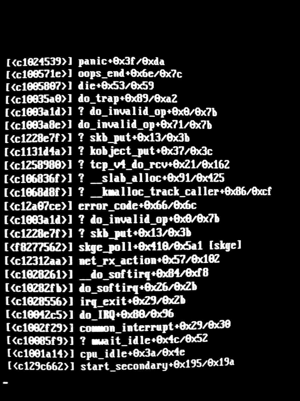

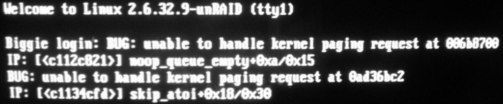

A few days ago, I decided to upgrade from 4.5.1 (which I have had absolutely no problems with) to 4.5.4. After I updated and rebooted, everything was working fine... for a few minutes. Then the server crashed. I attached a monitor to the system, and upon reboot, it froze while loading bzroot.
After letting the system sit with the power off for a while, it booted up, but then crashed again after running for a bit. Nothing pertaining to the crashes shows up in the syslog (I have tried looking at the syslog after a reboot, and also viewing it in telnet while the server is running, up until a crash). I took a picture of a couple different errors that show up on the monitor when the system crashes.

Please run Memtest, and if no errors are detected, post your hardware config.
Hmmm.... I ran Memtest yesterday and didn't get any errors, but I just ran it again now and got a bunch of errors and a crash on Test #4 Pass 1. So I guess I'll try replacing my RAM and see if that solves anything!
Coincidentally, when you upgraded your unRAID version, your RAM got damaged.
If the RAM replacement doesn't solve the problem, let us know.
