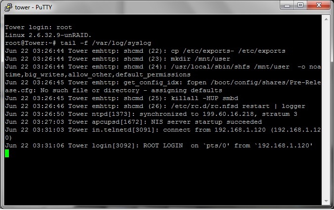

To capture a syslog that might show the crash, open a telnet session and then type this command:
tail -f /var/log/syslog
Now try to make it fail.  Any generated syslog entries will appear in your telnet window where you can select/copy/paste into a post.

Removed the cache drive. I don't think I get anything useful to show in the telnet window. Log is right before I cause the crash.
Sorry if this was posted in the wrong place. I haven't the slightest idea as to whats going on as I can't seem get any info of whats happening when the crash occurs.
