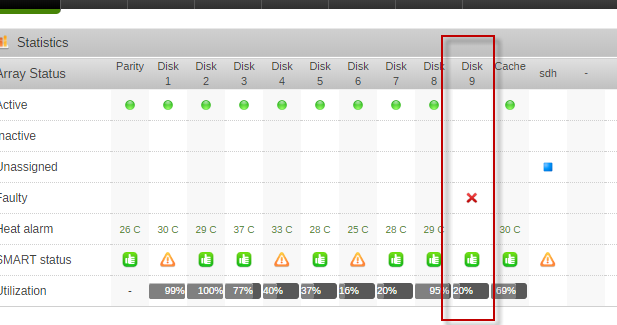

There's what looks like a problem with the disk, it dropped offline and was disabled, so there's no SMART report, reboot and post new diags
I was wrong, only looked at the file size, Disk9 has SMART disable, you need to enable it first:
smartctl -s on /dev/sdl
Then grab and post new diags.
Disk4 is failing, this will make the rebuild of disk9 challenging, do you have notifications enable?

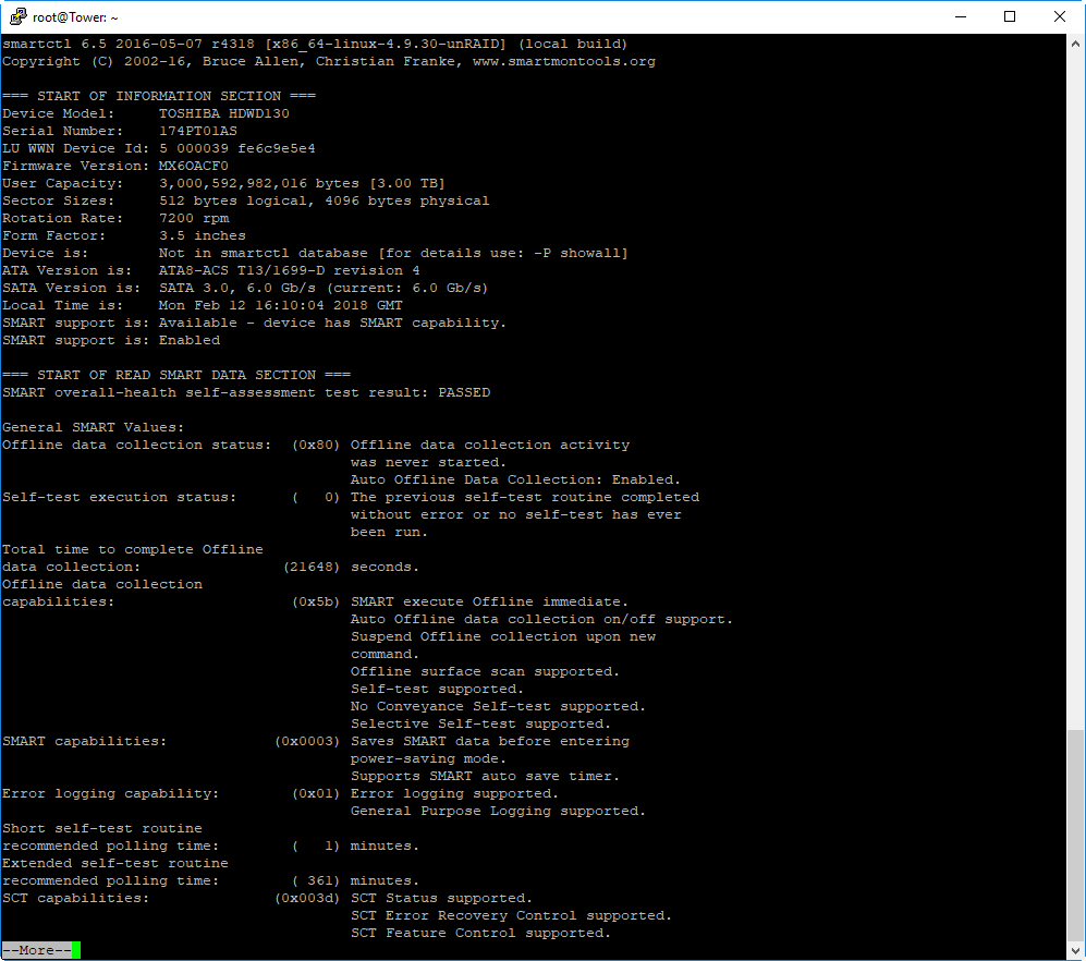

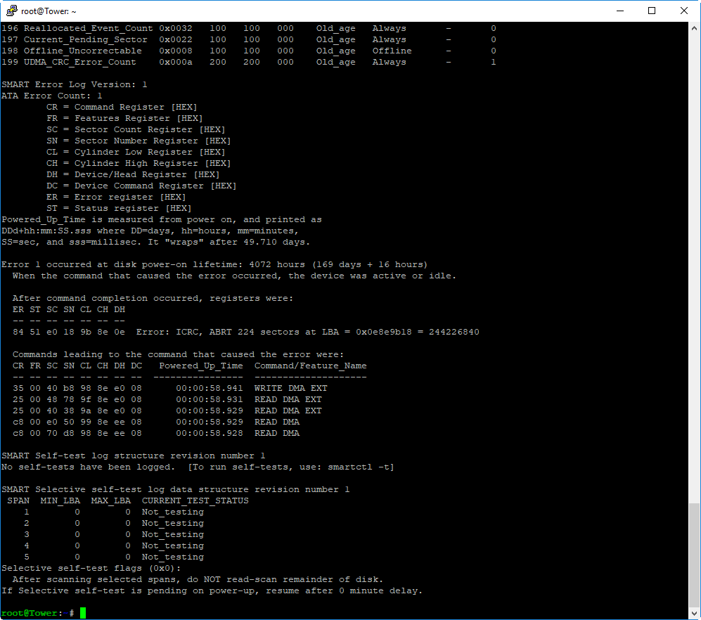

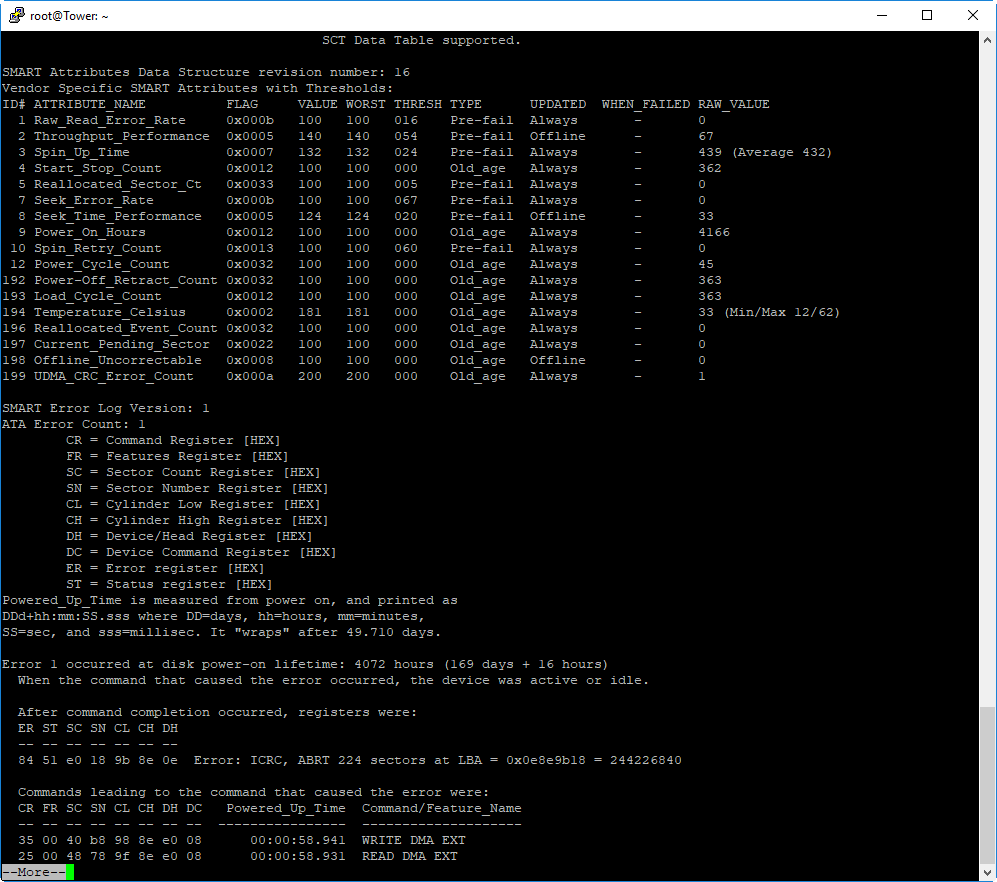

Apologies, several screenshots. Couldn't think of an easy way of getting a file off the machine;
Disk looks fine, there's one CRC error, not a big deal but might indicate the cable is a problem and reason why it got disabled.
