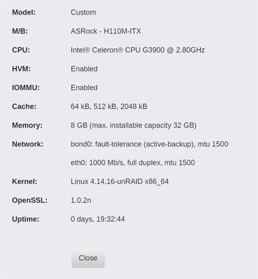

Good afternoon, I have this configuration:
ASrock H110M-ITX + Intel G3900 (Intel HD graphics 510)
Installed windows 7 x64, I do not know how to activate the integrated graphics card in it.
Could you help with this? Step by step, if possible

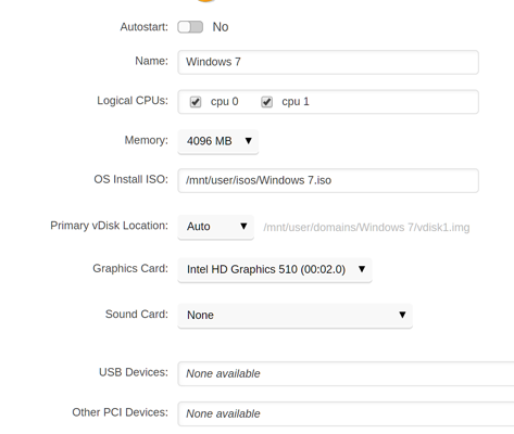

If I note Intel 510 in the VM settings, in Windows 7 in the device manager I see the VGA adapter, tried to install the driver on the video card, received error 43

My info and settings VM:
5a93f7ff514eb_info2.PNG.d0d659a7b650f2e296c277dee3a96e99.PNGinfo.PNG.f31af35287940e9f97e345077e60facd.PNG

Hi Leliil,
I would definitely double-check your BIOS settings.  Make sure Above 4G decoding is turned on if available.  This could be just an issue with that particular chipset.  IGD assignment isn't 100% flawless just yet, and because each iteration / chipset can change things a bit, there may still be some limited support.
I'd also suggest attempting this with Windows 10 to see if it's a driver-specific problem to Windows 7.
I'll try. what bios settings do I need to check?
