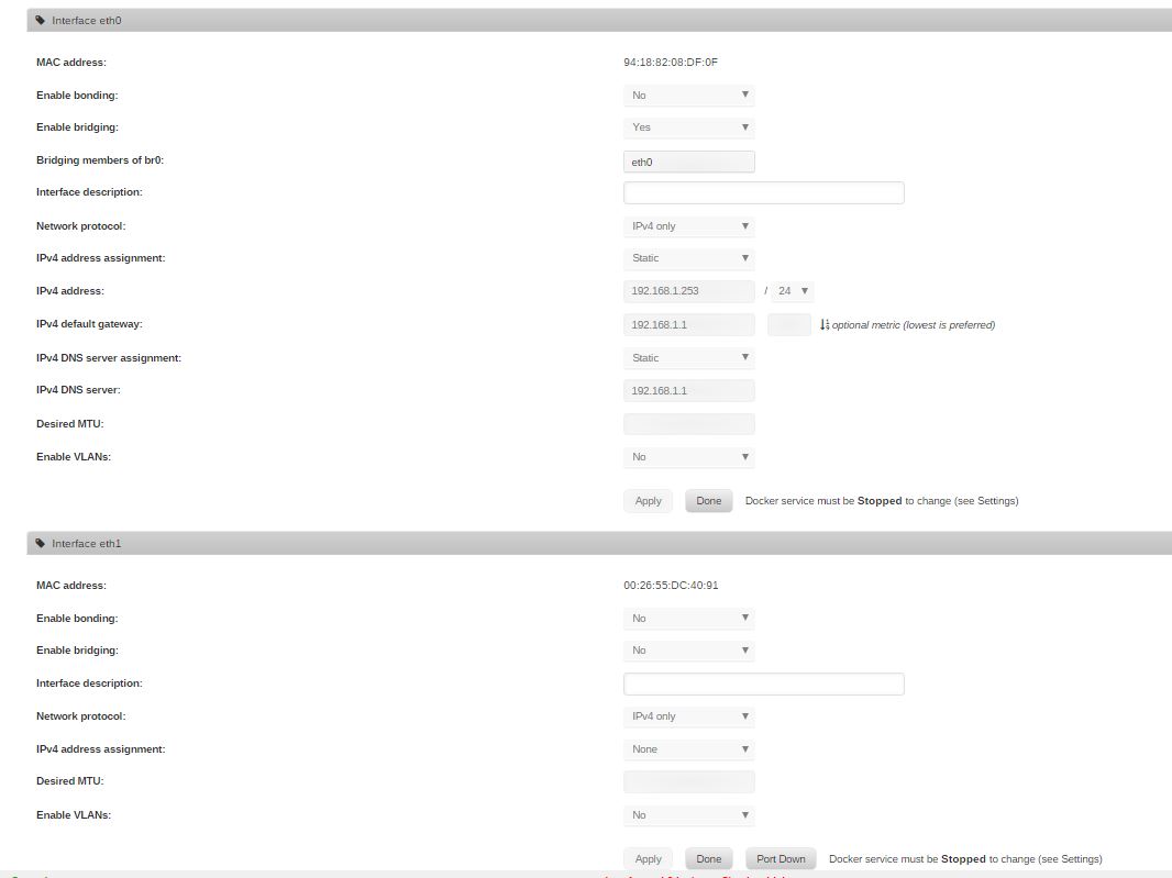

Attached you can find my current working config, where my internal NIC is eth0. Any ideas how to get eth1 as the main NIC?

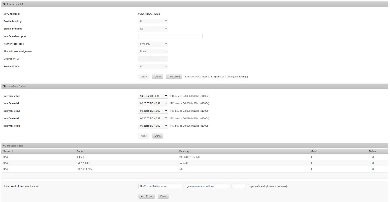

I don't think you can - the GUI is tied to eth0. Instead make your external NICs eth0 to eth3 and your internal NIC eth4 (in the section Interface Rules, near the bottom) then create a bond that includes eth0 to eth 3, excluding eth4. You can then set up eth4 as you would like, with its own IP address.
Edited by John_M
More detail
Would be also ok, but If I switch the internal NIC to eth4 and the others to eth0 to eth3 then somehow everything stops to work...
I will test again tomorrow.
Br,
Johannes
It will stop working until you plug your network cable into the correct port. You have four to choose from until you create the bond, after which you can use any of the four.
I reverted everything back, then started again from the beginning and now it worked!
