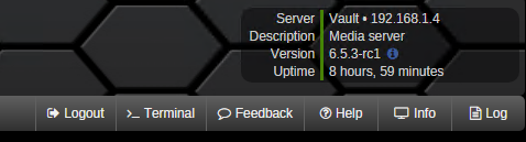

About 9:30 seconds into this video he talks about adding rcu_nocbs=0-7, I added this on my setup and its been stable for about 9 hours now.
