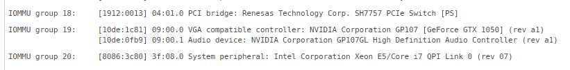

I dug a little deeper and found that my gpu is in it's IOMMU group which is good I guess. But how do I pass that group through to my plex container, so I can have the encoding and decoding happen on the graphics card?
