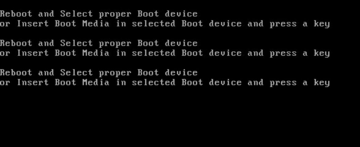

I rebooted my server and logged in using my IPMI and got :
Reboot and Select proper Boot device
or Insert Boot Media in selected Boot device and press a key
Please any help would be greatly appreciated:
EDIT: When I restarted the server, I could not see the portion where I can go to the BIOS or select the boot device
EDIT1: I plugged the USB drive to my Linux laptop and when I do the lsusb it sees it as
Bus 001 Device 010: ID 0781:5583 SanDisk Corp.
Also, I checked my GParted, and it sees it as /dev/sdb1.

2 hours ago, johnnie.black said:
Try redoing your flash drive.
I hope it is not too much to ask. I really don't know what I am doing here. Could you link me to the process of redoing my flash drive.
  1. Is it just buy a new flash drive then install unraid as a fresh install?
  2. I know it was in 6.5, but I am 100% sure that it is not the latest. Would the version matters?
  3. How do I recover the license? I have the 12 drives license.
  4. I do not have a backup of my flash drive. What options do I have and how bad is my situation?
First try redoing your current flash drive:
-connect it to a PC and back it up
-redo it, you can use the Limetech USB creator tool
-restore the config folder from the backup to the flash drive
I finally got two 16GB sandisk flash drives.
I plugged my old flash drive to my OSX laptop and somehow I am able to see the stuff on it. I copied all the stuff from the old flash drive to a folder on my laptop.
Should I install the unRaid 6.5.3 to my new flash drive via Limetech USB Creator?
What should I copy from my old flash drive to the new flash drive?
First try the old flash drive so you don't need to transfer the license, only if it fails you should try a new one, and you can try it without the license first to make sure it works.
