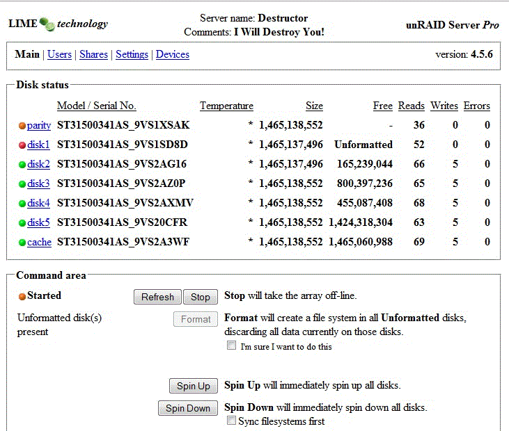

Ok. I hit stop and then start but after saying "mounting" on the dodgy disk1 for a few seconds went back to unformatted and red.
When I rebooted it still said the same thing.
Seems strange that the check tool can see all my files (i see them pop up when its checking) but unraid sees it as unformatted... is there perhaps a way (if there isnt a way to get unraid to see it...) i can mount it myself outside unraid and copy to another drive in the array?

Is there perhaps a way you'll post a syslog now, so we'll see the real reason for the "red" indication.  For that "red" indicator to occur, "writes" to the drive must have failed, but the only way to know what is happening is to see the syslog.
Point taken, I'll stick to reporting what I see =)
Syslog is attached.

I see no failing "writes" in this syslog, therefore I'm going to assume they were from before you rebooted and had disk1 un-assigned.  The disk is being emulated, and since you did NOT run the reiserfsck on the /dev/md1 device, but instead on the actual physical device, it does not see the repairs you made.
You can probably now initialize the disk configuration, and then tell unRAID that the parity is OK (even though we know it is NOT) and then let it perform a full parity check where it will find differences and get parity back in sync with the disks themselves.
So...  To do this you need to "Stop" the array
Then, log into the server via telnet or on the system console and type these two commands:
/root/initconfig
It will prompt you to be certain the array is stopped, respond with "Yes"  (Upper case "Y", lower case "es")
Then, type this command:
/root/mdcmd set invalidslot 99
Then, back on the web-interface, press the "refresh" button on the browser.  All the indicators should show as blue.
Lastly, press "Start" and let the parity check run to completion.  It will find parity errors... do not get alarmed when you see them as you caused them when running reiserfsck on the /dev/sdc1 device instead of the /dev/md1 device.

That syslog is current, from the machine as it is right now after rebooting. I've attached a screenshot too.
Are you sure the drive is being emulated? The parity shouldn't be valid as it was before i took two hard drives out.
I tried running "reiserfsck --check /dev/md1" but it said
The problem has occurred looks like a hardware problem...
and
bread: Cannot read the block (2): (Input/output error).
Aborted
And in the syslog it added
Sep 1 00:04:44 Destructor kernel: Buffer I/O error on device md1, logical block 2
Sep 1 00:05:47 Destructor ata_id[2792]: HDIO_GET_IDENTITY failed for '/dev/block/8:32'
Sep 1 00:05:47 Destructor ata_id[2816]: HDIO_GET_IDENTITY failed for '/dev/block/8:48'
Sep 1 00:05:47 Destructor ata_id[2831]: HDIO_GET_IDENTITY failed for '/dev/block/8:64'
Sep 1 00:05:47 Destructor ata_id[2844]: HDIO_GET_IDENTITY failed for '/dev/block/8:80'
Hooray its all fixed!!!
I took the drive acting up out then did "initconfig" and started the array. I cancelled the parity check, put the drive back in, assigned it to slot one and started it up again! Hooray!
"Unformatted" threw me a little bit. It seems the drive was formatted just fine? Perhaps there's a better word for it (or far more likely I just dont really understand what was going on).
Parity is being rebuilt now. Thankyou very much for the help all =) I now have a motherboard that wont destroy my drives (unless cmos loses power :/) and a slightly better understanding of the tech I rely on to keep all my media in order.
