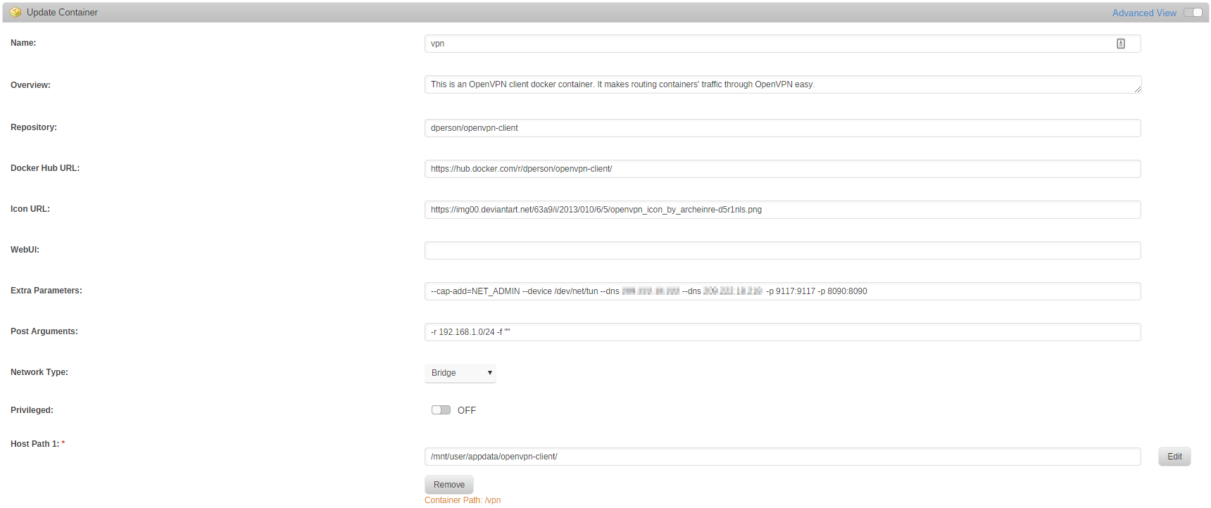

I have a VPN Client Docker (dperson/openvpn-client) [called "vpn"] that's permanently connected to my VPN provider (PIA in my case)

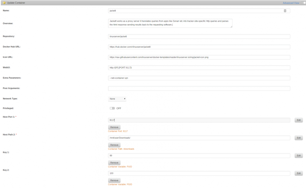

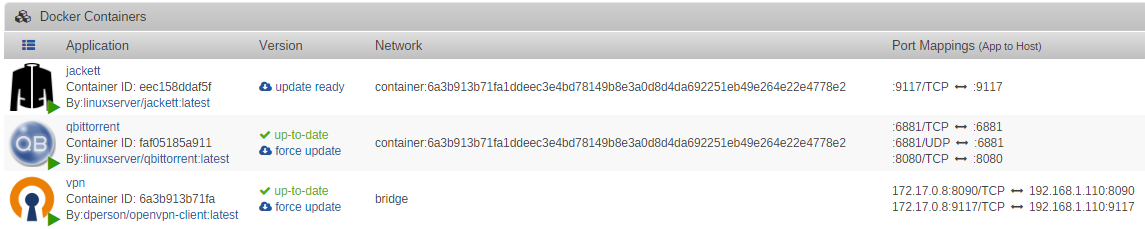

I then have 2 dockers which tunnel their network through that container (jackett and qbittorrent)
At present I have come up with a bit of a hack after lots of messing around where I set the 2 dependent containers Network Types to "None", then add into "Extra Parameters":
--net=container:vpn
Hopefully this could include a UI update that would use the containers name instead of the UID too
