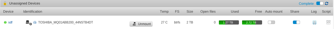

It might be stating the obvious but have you set the Share slide switch to enable sharing?

EDIT: Maybe toggle it off and then on again in case something has got confused.

Yes I did set the Share switch from the beginning thanks, if not I don't think it would've showed up in MC?  But still not visible from Win 10.

MC running on unRAID itself? No it doesn't need to be shared to show up under /mnt/disks/ It just needs to be mounted. Maybe your smb-extra.conf file got messed up, which is why I added the suggestion to toggle sharing off and on again.
