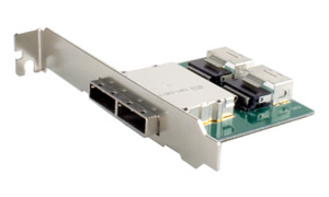

You can use something like this (click to expand):
Adapter from 8088 to 8087, then an internal 8087 to 8087 cable to the expander.

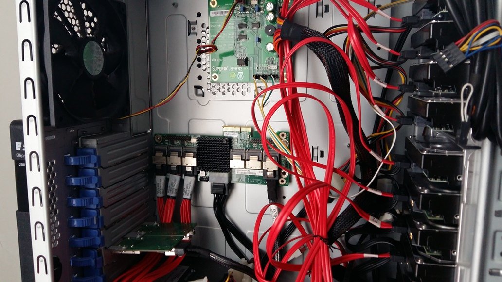

atxsas_jpg_fe3db86ffc5f900bd98177934c867
Made some notes on the img to ensure i understood what was going on.
Ok, so i wont be going the HP route. Upgrading my hardware, i don't want to go backwards with the expander. So what affordable SAS expanders should i look at, that wont have an issue with unRAID? Just had aquick look on eBay, looks like the only expanders in Aus are HP's!
Is the IBM 46M0997 ServeRAID Expansion Adapter 16-Port SAS Expander sufficient? IBM will ensure compatibility with my server...
From image:
What expander is in use in the photo? Is that molex power an addon or part of design?
Those PCI boards, what exactly are they called?
The SAS Expander is taking input from the HDD's, and also outputting - Are there designated ports on the card for input/output? Or is it a feature of an expander that it can detect inputs/outputs?
What's the role of the SuperMicro board, and can they be purchased individually? Name/model? It necessitates the need for a motherboard correct?
It's an Intel RES2SV240, it can be powered by molex or PCIe.
Do you mean the SFF-8088 to 8087 adapter? it's called that or SFF-8088 to 8087 bracket, like this:

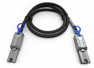

External ports connect to the server, to an HBA with external ports or to another bracket, with cables like these:
These cables are shielded and can be up to 10m long (including the internal cables from the HBA to the adapter and/or the adapter to the expander, if used) but you want to keep them as short as possible, I use 2 meter cables.
All ports can act as imput/output, similar to a network switch, one or two ports are connected to an HBA, the remaining to the disks.
It's optional, just so you can use the case buttons to power on/off, I bought it because found one very cheap, initially I just had a clip on the PSU to power on, p/n is CSE-PTJBOD-CB1
Seems pricey compared to everything else, however it's also the only one i've seen with an independant power input which is a BIIG plus.
Thanks, assumed as much, but wanted to ask whilst i had the chance!
8088-8088 cables, already sitting in my cart :)
