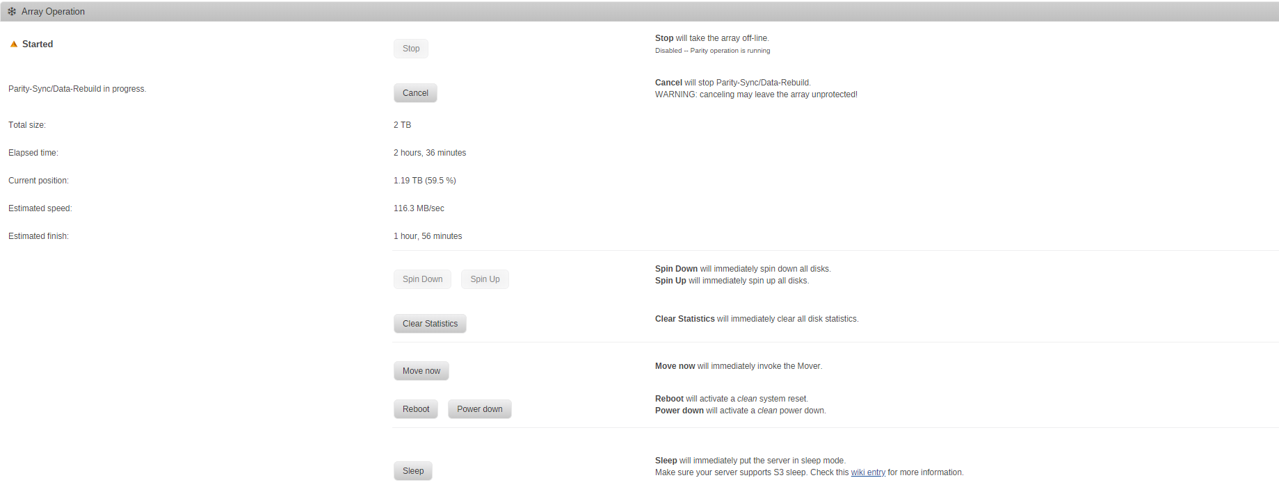

Well things seem to be going ok I followed what you said and it just mounted the parity and started to rebuild disk3. I have definitely learned my lesson, as soon as its back to normal I am going to add another 2tb parity drive. thank you so much ill post back once its finished rebuilding :)
Is disk3 mounted or showing as unmountable?

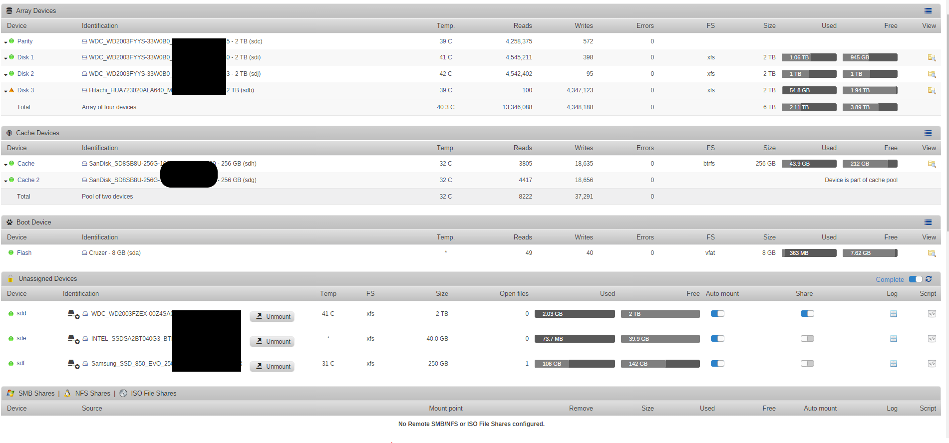

I believe it is mounted and rebuilding it was precleared and sitting on a shelf waiting to go in if something happened its the Hitachi
Thank you so much for your help, Everything seems to be back to normal operation is there anything i should look out for? Or is everything fixed? It ran a Parity sync and data rebuild should i run a scan to check the data again? Again thank you
Disk mounting is a good sign but run a file system check and spot check some files to see if all looks good.
