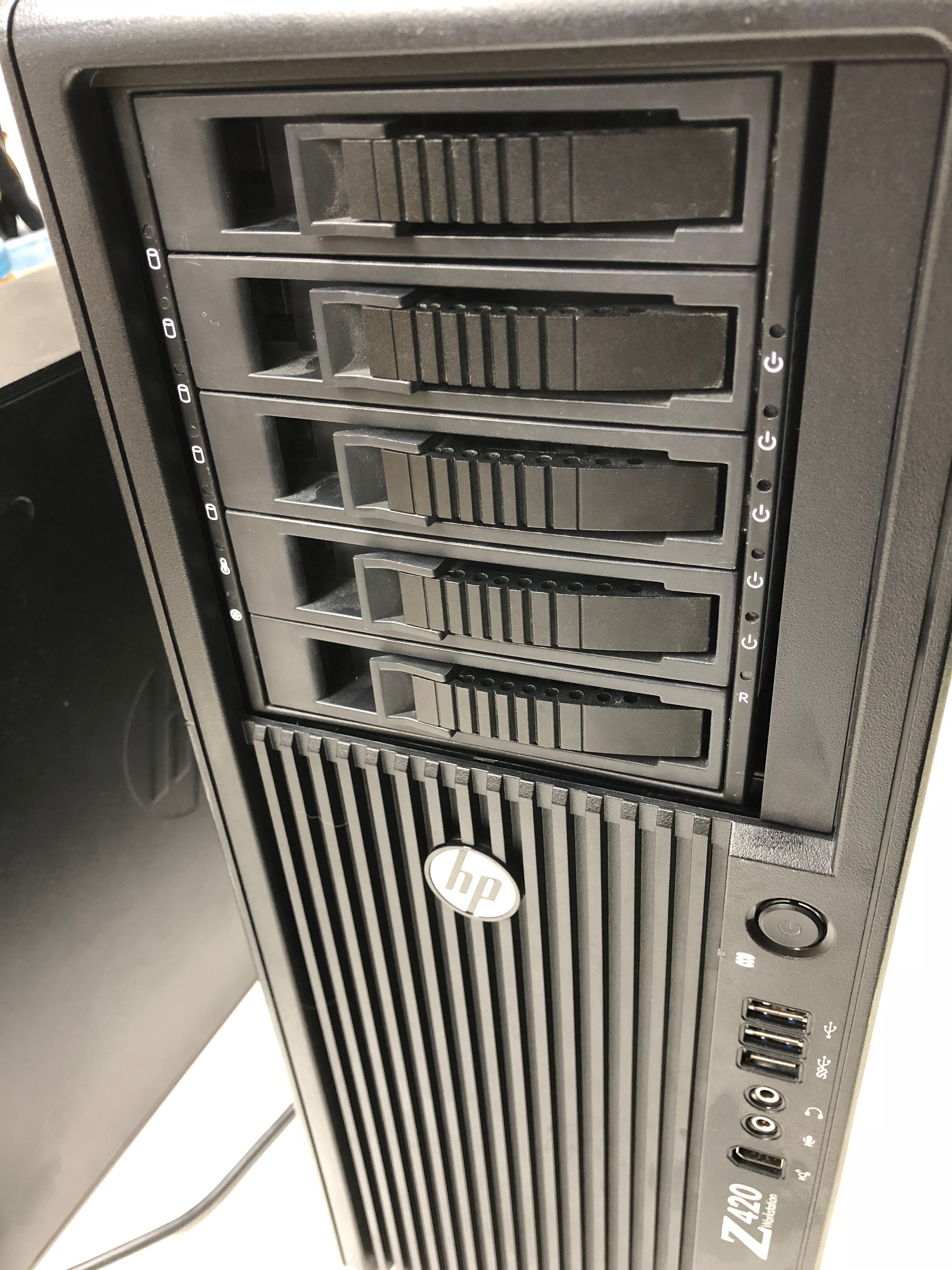

I have a iStarUSA BPU-350SATA-BPL in mine. I rotated the 5.25 bays to have the drive trays horizontal.  It clears the mobs fine. It was still a tight fit and I had to "trim" on the long hp screws so they wouldn't interfere with the trays.
I'll try to take a picture later if you'd like.
that would be fantastic!
Here is how I have the cage turned in the z420.

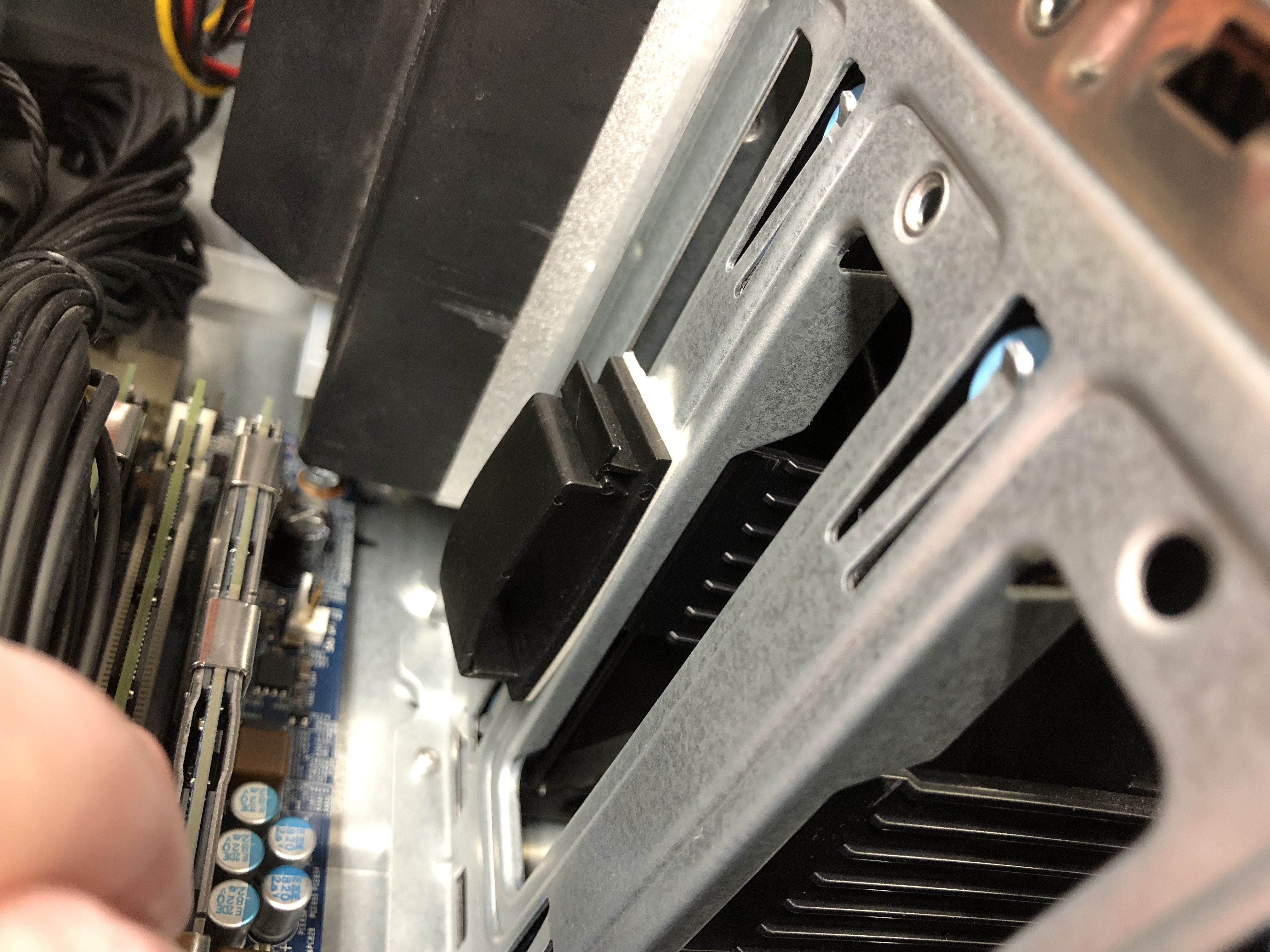

And here is the space on the backside, turning the drives the way I did put the spacer on the motherboard side which helped a lot.
Hope this helps.

I have seen a few models of the BPU-350SATA. From what I can tell it’s just a matter of color
Just got mine in and she fits!
Figured out what you meant about cutting the screw short the hard way lol
