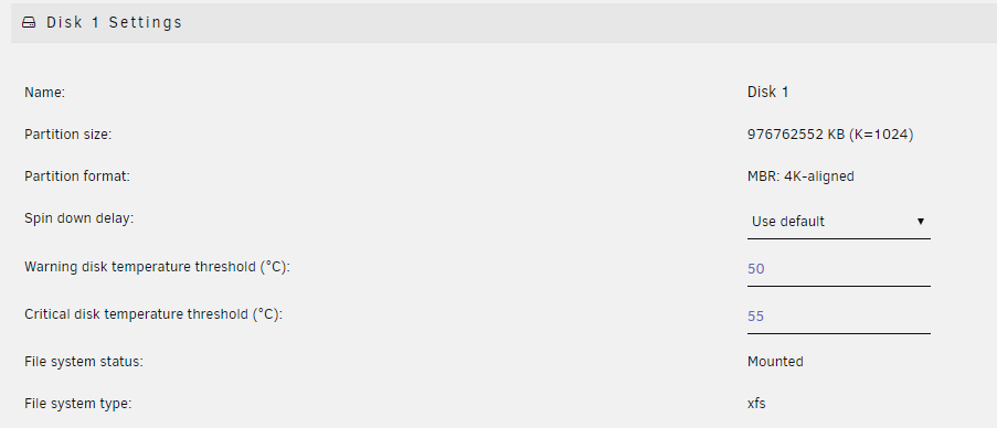

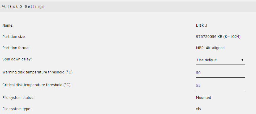

Yeah it looks like it, but Unraid doesn't allow to use it as a parity drive because it's smaller. I added the disk to the array and after formating to xfs the size differs.
image.png.576b7047906d345a19f8190c9e6cf77c.pngimage.png.8ef554a3b8bf62e2bde07e8f69eef57a.png
