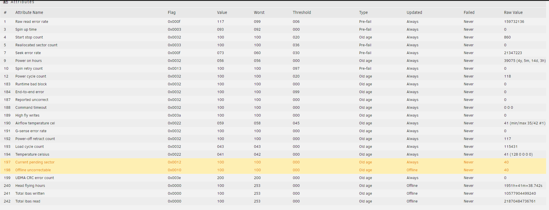

My current parity drive is showing errors and is likely to fail soon.  I'd like to use a current data disk as a parity disk.  What's the best way to move the data off of that disk, get it out of the array as a data drive, and into the array as a parity drive?

I had a relatively new drive in my array fail on me.  Sending it in for a warranty replacement, but just after it failed, my parity drive started showing "Current pending sector" and "Offline uncorrectable" errors.  I have no idea what these mean, but Google says it's a good indication of failure coming soon.

If the current parity is showing pending sectors it's possible (even likely) there are read errors during the rebuild, if notifications are disable check main page for errors, or post the diagnostics.
Hmmmm... That's disheartening.  I do have notifications enabled.

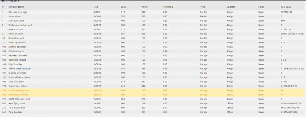

When I check the raw read failure rate, it is elevated.  It's showing prefail at a value of 117.
Does this mean the rebuilt data will be corrupted?
Brandon
Nevermind... I was looking at this wrong.  The read errors seem to be sky high based on the raw value.  Is that what I should be looking at?  Not entirely sure here.
Brandon
You should be looking at the error column on the main page, in doubt post the diagnostics.
Ah, ok.  Good news... 0 errors there.
Brandon
Check when the rebuild finishes if it's still 0, though if you have system notifications enable you'll get notified.
As for the copy to remove the disk, you can use mc and move the data from that disk to another (not to an user share) or if you have disk shares enable you can also use Windows explorer, the copy/move will still be made locally, then new config, keep all assignments, unassign the now empty disk, assign it as parity and start the array to begin the parity sync.
