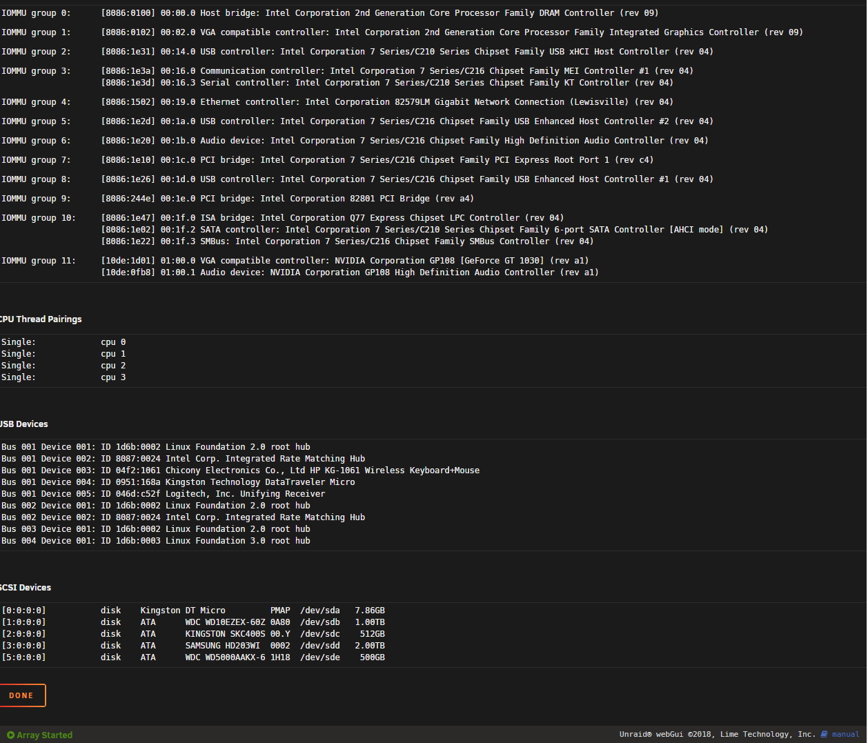

I have problems with my vm audio (crackling audio). They started a few months ago when i updated my unraid os and got worse a few days ago when i updated to 6.6.5.

I have attached my system devices and vm xml to this post.

Hello, i have tried to enable msi mode for gpu. It shows enabled in msi utility v2 but as i said i there should be two instances: gpu and gpu sound device. The sound device is not showing up in msi utility. I also tied to tweak my registry in vm, i didnt find my gpu's sound card from there att all with pci id.
