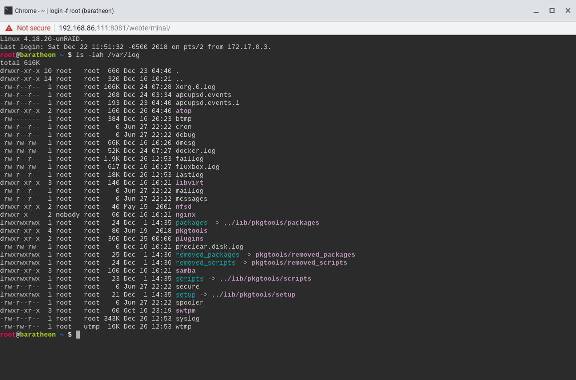

Well your syslog isn't to blame.
Click on >_Terminal and enter this at the command line then post a screenshot:
ls -lah /var/log
Here is the screen shot of that dir:

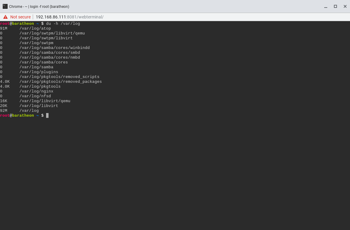

How about this one:
du /var/log
Ahh, nice- atop is causing the problem.  Forgot I had that installed with nerdtools plugin.  Thanks for the debug help (I'm going to mark this as solved)!

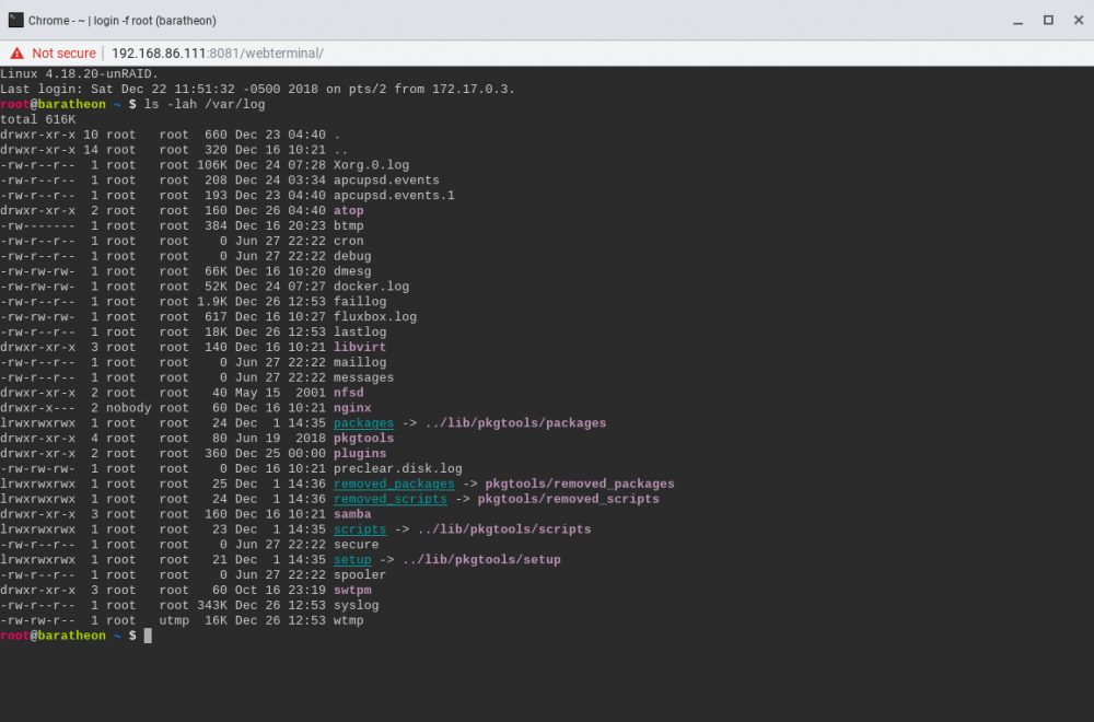

Just for completion's sake, here is the output (with -h flag as well):
