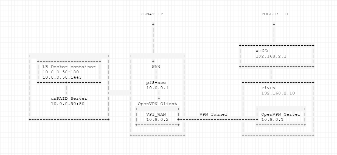

I am trying to get over my cgnat problem and people suggested  online  to  VPN  tunnel to  a  server  with a public IP. Now,  I was able to  connect from  my  pfSense  to the  raspberry  pi with  PiVPN. How can  I  make  the  duckdns validation?
/etc/openvpn/server.conf

 /etc/openvpn/client/vpn1:
push "route 192.168.2.0 255.255.255.0 10.8.0.1"
ifconfig-push 10.8.0.2 255.255.255.0
iroute 10.0.0.0 255.255.255.0
Sometimes I  can  ping  the  pfSense from the PiVPN  but not  vise  versa. Should better opt to try SSH tunnel instead of  OpenVPN site to site?
If  you  need  more information just let  me  know. All suggestions will help!
