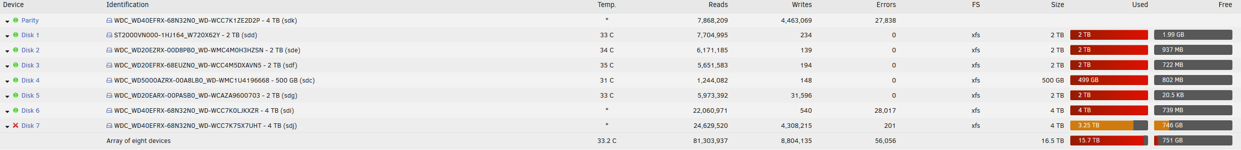

Hey all, just had Fix Common Problems tell me that I had three drives disabled and with read errors. All of which I believe are connected to my PCI 4 port SATA controller.
Diagnostics attached. It appears 2 of the three drives have come back online as they dont have red 'x' next to them??
Not sure what to do from here?
Any help appreciated.

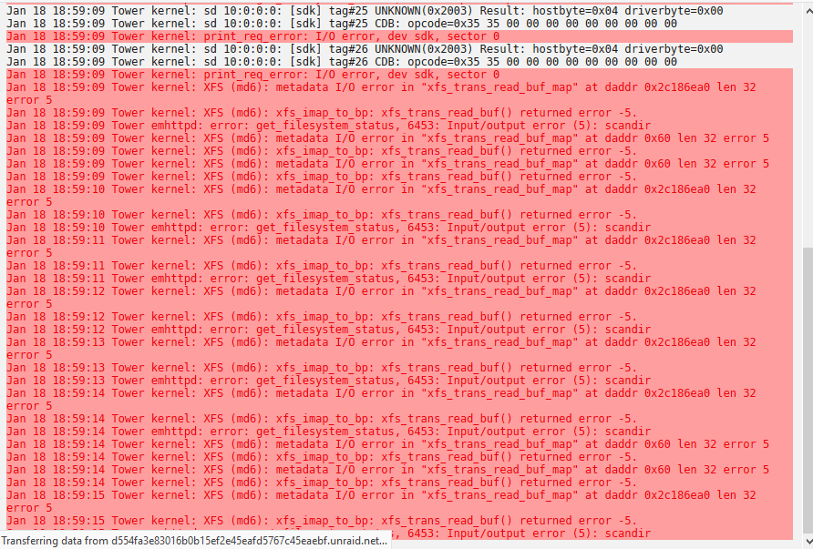

You have one drive disable, three with read errors, Unraid doesn't disable more drives than the number of parity disks in use.
Problem appears to be the Marvell controller, all 3 disks with errors are connected there, I would recommend you replace it, Marvell controllers have a tendency to drop disks, it is known, first thing to do is to reboot (by force if needed) and post new diags so we can confirm SMART for the dropped disks is OK.

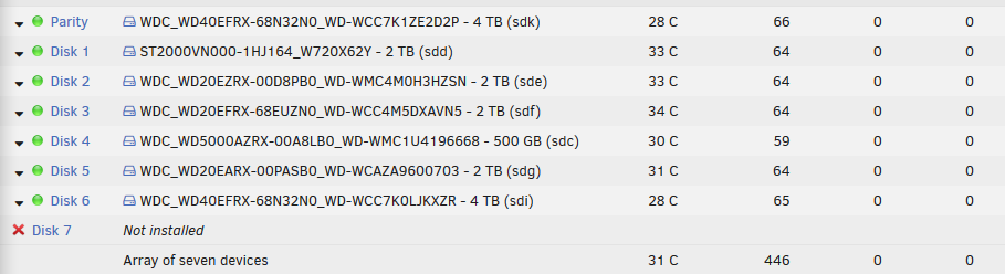

Ahh I think the controller is stuffed! Unraid is now saying Disk 7 is not installed.
8 minutes ago, johnnie.black said:
That's not the correct device since it's missing the partition, still and to keep parity valid you need to use the md device, as it says in the link above, it should be:
xfs_repair -v /dev/md7
That command still seems to work even though it says disk is missing and it doesn't report any errors.
That's expected since it's running on the emulated disk.
