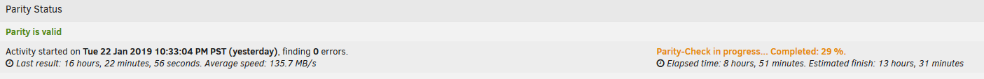

I moved the four drives in my existing array from built-in motherboard SATA to a Dell PERC H310 (taped and flashed to IT-Mode) in preparation of adding additional drives. Parity check progress was estimating weeks to months to complete. I let it run 8+ hours overnight and it was 29% complete (Average speed: 135 MB/s).
I have shutdown the system. Can you please check the attached diagnostic and let me know if there is an issue that is causing the parity check to take so long?
