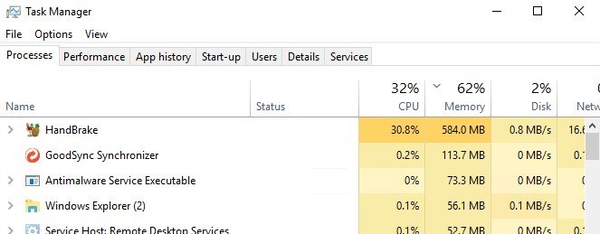

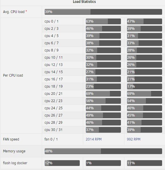

I am experimenting with a Windows VM to get the fastest possible HEVC Encoding process but find that a VM on my 2950X Threadripper barely uses the CPU Power available?
Is this just a reporting issue or is it correct?

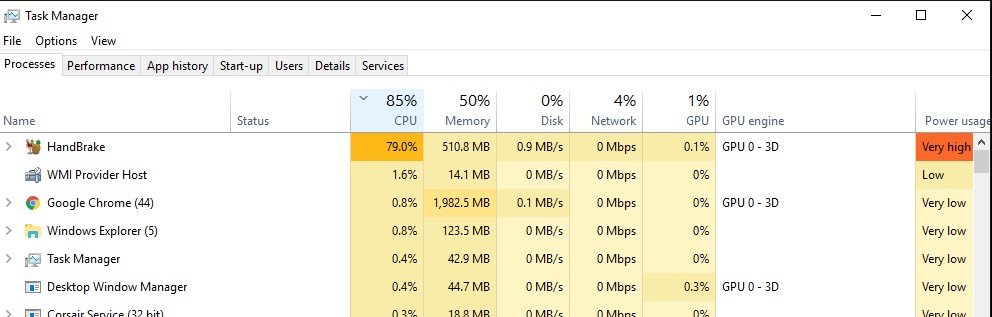

If I encode natively on my I7 8700K Handbrake uses 80% of my CPU using the highest priority but the VM uses 30% Please look at the screenshots and any advice is greatly appreciated! 🙂

I had found some info on this earlier on the Handbrake forum regarding NUMA, I am getting better results using less cores when using handbrake, I am now looking for another cpu stress test that is not handbrake to give me a better idea of results when configuring.
Many Thanks for the reply & if you can recommend a better stress test I would appreciate it! 🙂
