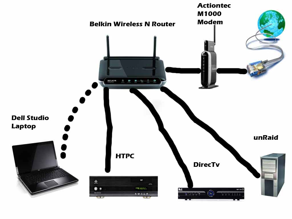

its connected to my routers yes,
funny thing is my htpc running linux does not show up in the DHCP list only my droid phone and win 7 laptop, however I have access to my htpc over the network and via DynDns.

I can ping the HTPC from unRaid and it can ping the HTPC, but for some reason my Win 7 is FUBAR

In your Win 7 machine
(a) Do nslookup with your gateway as default server in DOS window and post result back
(b) Do "route print" in a DOS window and post result back.
Meanwhile, draw a diagram about the layout of your home network.

Diagram on the way
-=Jason=-
modem is set to transparent bridge mode
router is using PPoE settings
