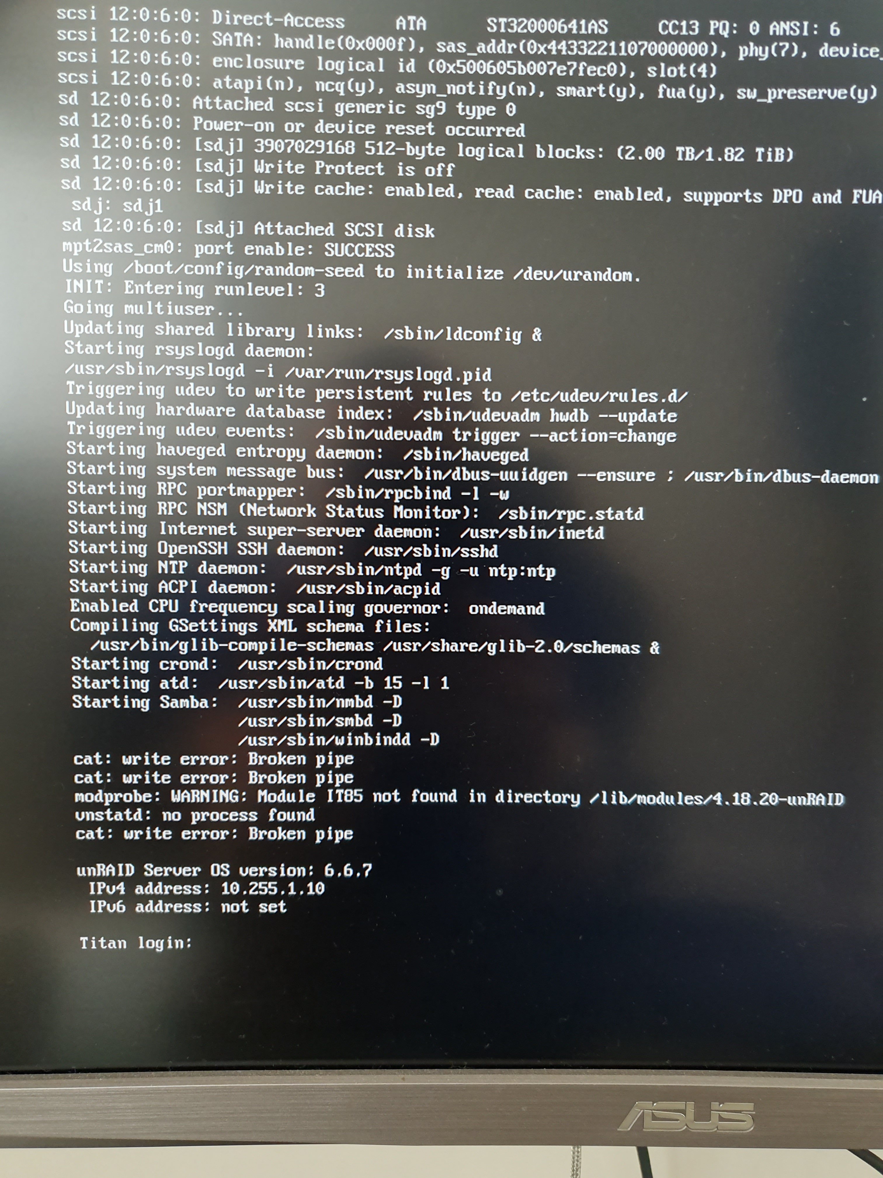

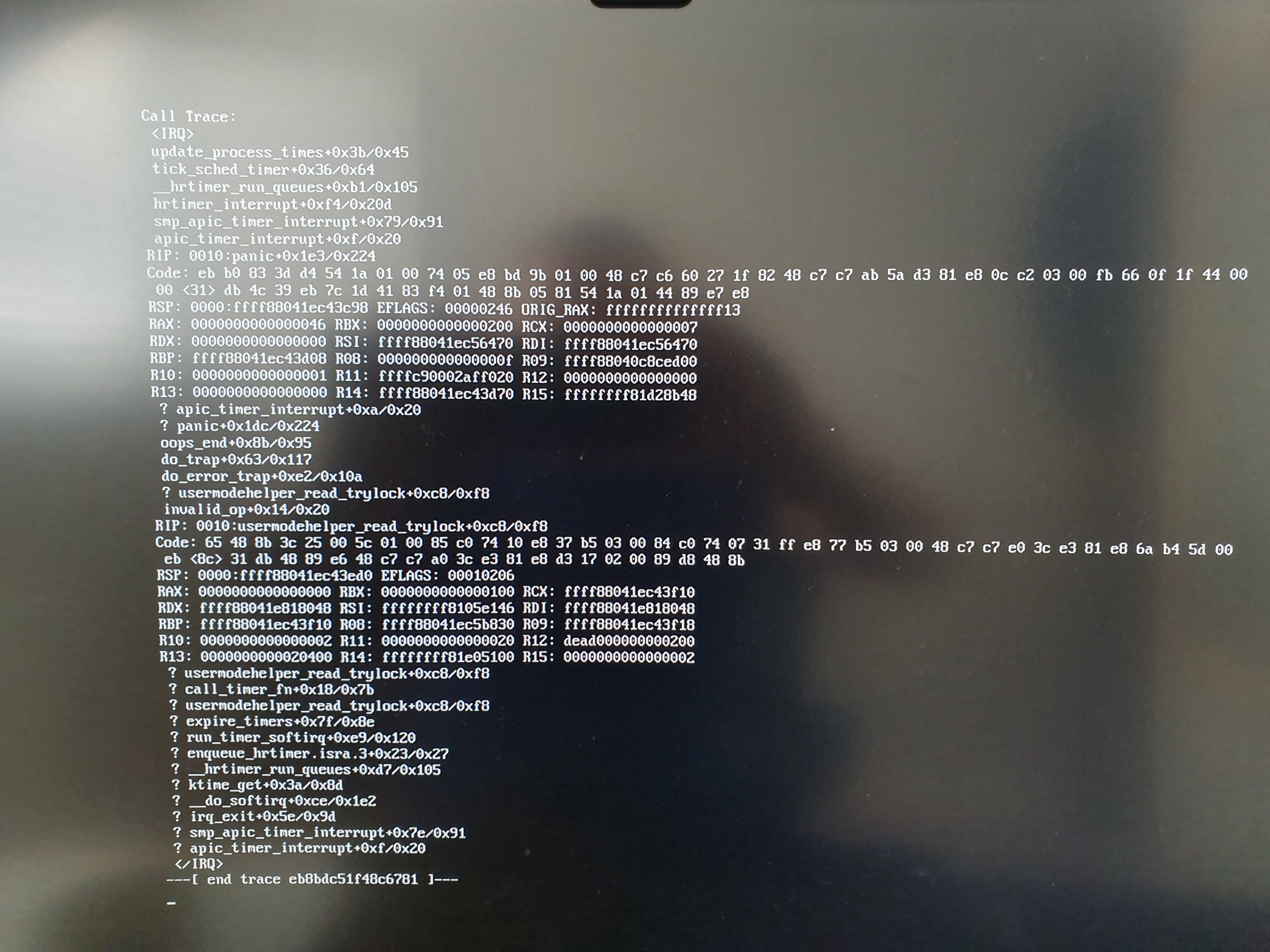

I managed to capture two pictures of the crash, one which appears to be a kernel panic, the other some errors on boot. I have also uploaded a diagnostic in case that helps?  I am scratching my head on this one and would appreciate any help and assistance!

There are known issues with Ryzen and Linux, most workarounds are discussed here.
Thanks very much for the advice, I will have a read :)
