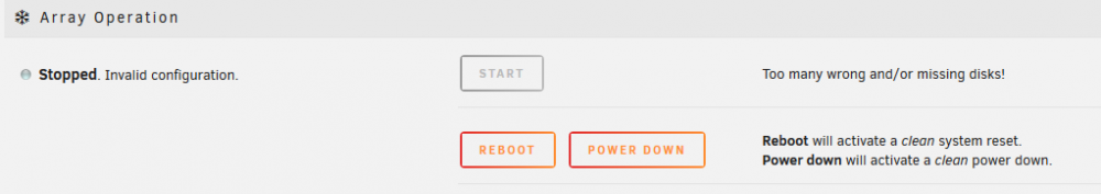

Problems following https://wiki.unraid.net/Shrink_array
I have a dual parity array and have recently done a full parity check without error, running the latest unraid pro...
I have a full printout of all drive assignments
I rsynced (with remove) all data off of three old 1tb hard drives (to the array) and confirmed they are empty
I shut down the array,
I changed the included shares list to only include the drives I want to keep in the array (checked all but 3 drives)
Then tools, new config, retain all, yes, apply
On main, I unassigned the three drives to be removed
double checked all other drives are listed correctly
I cannot start the array due to "invalid configuration" to rebuild parity without the drives.
What am I missing? Is this a bug? Is there a work around?
Shouldn't I be able to remove as many drives as I want and just rebuild parity?

6 minutes ago, bsim said:
What am I missing?
You didn't do a new config, or it didn't take, try again.
It looks like the "shrink array" page is the problem...It has you unassigning the drives after the "new config". Using a bit of logic I was able to figure out that unassigning the drives then "new config" works beautifully.  The document needs to be fixed.
And that's correct, though it will also work if you unassign them before.
I did attempt to unassign them twice after "new config", neither took (just invalid configuration both times)...could it be the removal of three drives at once that caused a glitch?
As soon as I did unassign before "new config" it worked flawlessly. Overall doing it before does seem to make much more logical sense for the process.
No, it will work as long as you don't start the array, while the drive icons are blue, once it's started you can't remove devices any longer, or until you do another new config.
Thats the point, new config then unassigning drives=the drive icons never went blue, and never gave me the option to start the array
until I unassigned before new config, then got the blueballs and the option to start rebuilding.
