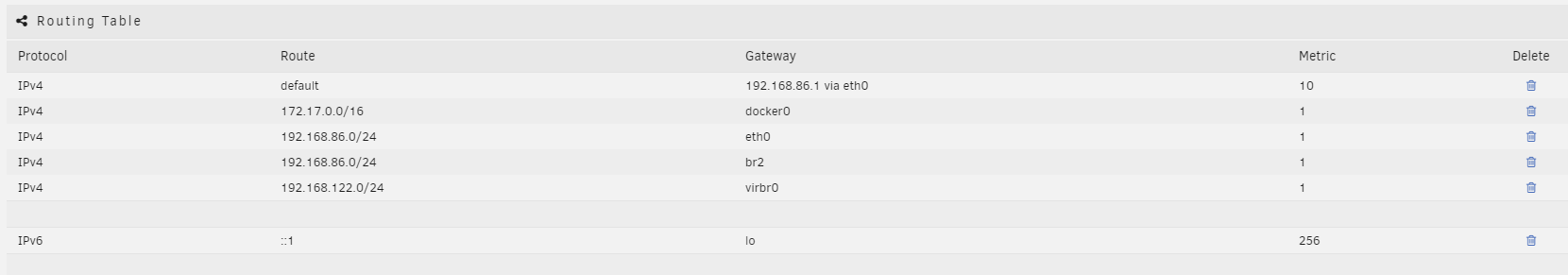

I can ping each docker from within a docker, but can't ping from any computer to any of the docker IPs and versa . Can't ping from within the docker to the gateway.
Each dockers network is set to br2 with a static IP.
Everything (unRaid, Computers and Dockers) is running on 192.168.86.0/24

You need to post your diagnostics for complete info, but I can guess the problem and solution.
Do not assign an IP to the br2 network interface. it is causing unraid to be accessible on both interfaces, but the dockers are only on one and its probably the wrong one now.
Recreate the custom docker network on br2 (after removing the docker network on eth0)

It looks like if I set eth0 to bridge and put the dockers on that bridge everything works again.
I have a 10GB Nic with 2 10GB ports on it that I want all the traffic to go over. That's my br2 bridge.
Any idea how I can set that as the primary instead of eth0, which is my 1GB onboard NIC.

Do not set two interfaces with the same subnet, unpredictable things happen - like the OS getting confused as to which interface it really should be using to talk to the rest of the world, which normally is ok, but causes issues with Docker and macvlan subinterfaces, which simply put, blocks docker containers with their own IPs from talking to the host on the same subnet.
