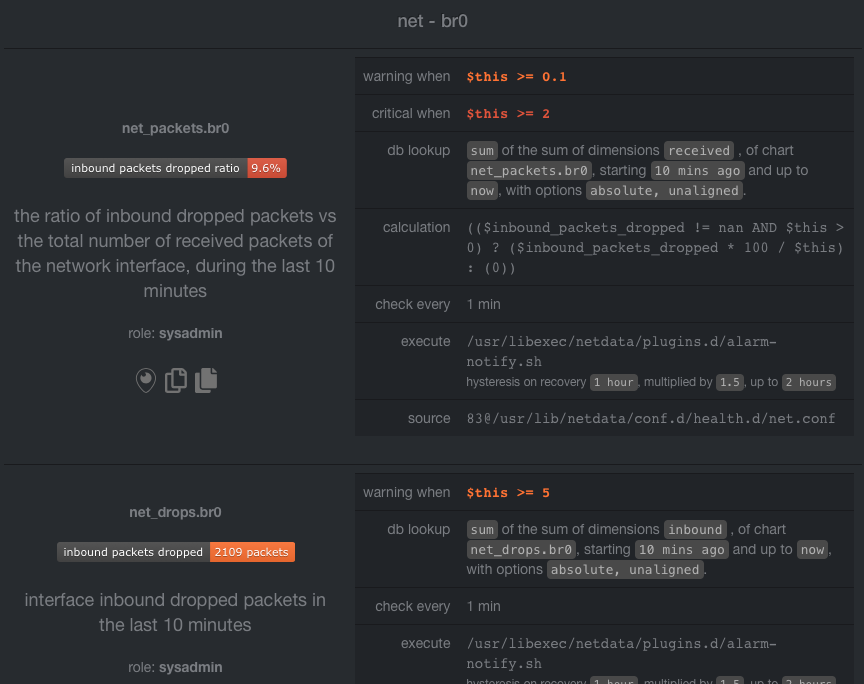

netdata tells me that my network interfaces br0 is dropping 10% of all packets.
what can i do to find out whats wrong?
i already checked settings>but i cant see the interface there.
785477152_Bildschirmfoto2019-04-13um19_56_56.png.41a44967688ed1fb35a97a84f468fc5d.png
