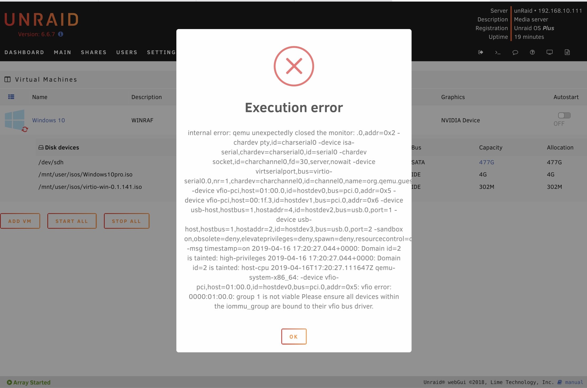

I'm creating my first vm with windows 10, I have followed all the instructions but I'm getting an error with the execution.
Your help is greatly appreciated

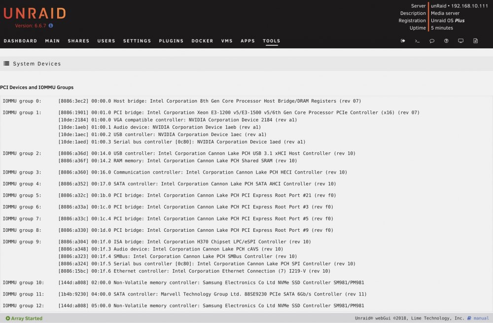

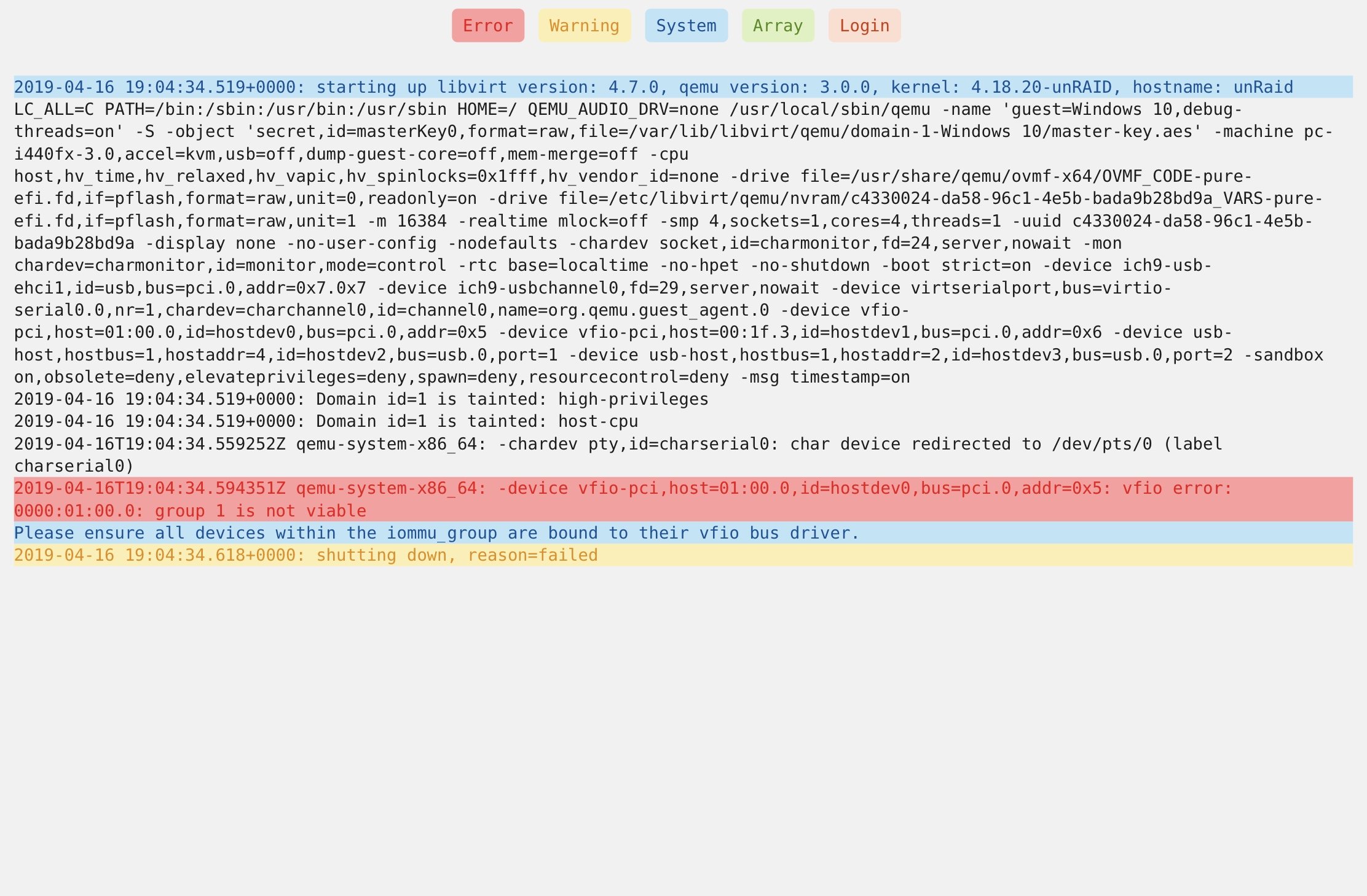

From what I managed to find out its the video card that's causing problem. Here are the logs. And the system ressources display. Group 1 looks to be my nvidia 1660
@tursiops You can't passthrough a device if it's not in its own IOMMU group separated from other devices. In your case you have a PCI bridge in the same group as the GPU. Go to your settings >> VM Manager and enable "PCIe ACS override" , reboot your server and check your system devices again.

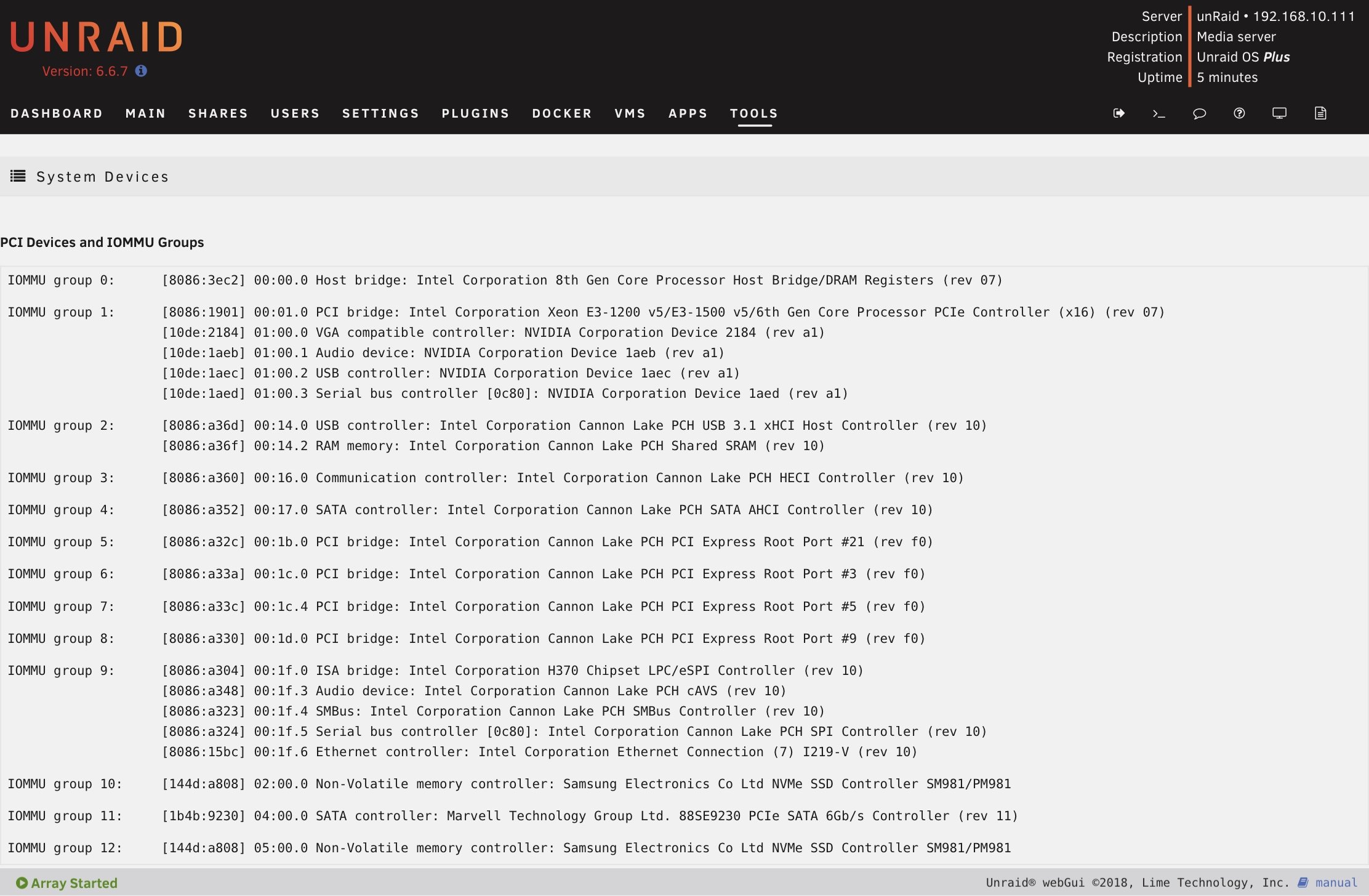

Ok I've done that and I can now add my gpu to my vm. But when I launch it I have no video. I'm connected to the third port of the card because it's HDmi my screen didn't have display port. Is it a problem? I heard that the card often only activates the first port which in this case is display port.
