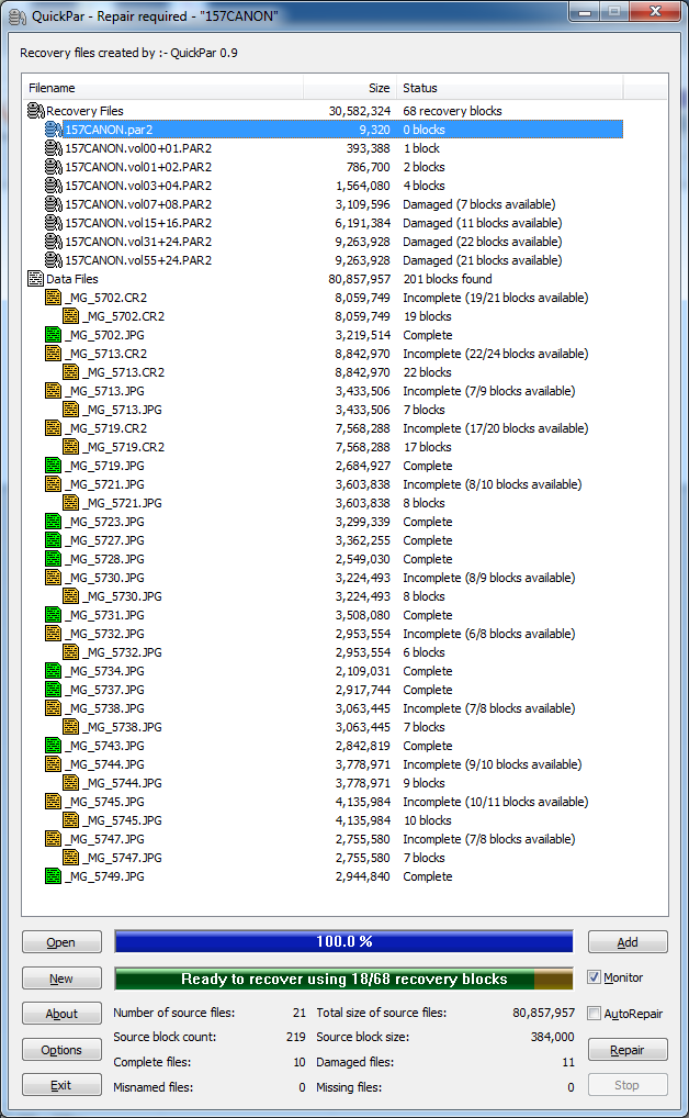

3. In some cases I have *.par2 files in some picture directories.  Running a par check indicates files are corrupted... but it seems like it's a "bit here and a byte there" (see screenshot).  Ideally I'd run a par2 check locally but I'm pretty sure its all local to the server now.
