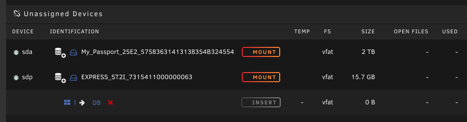

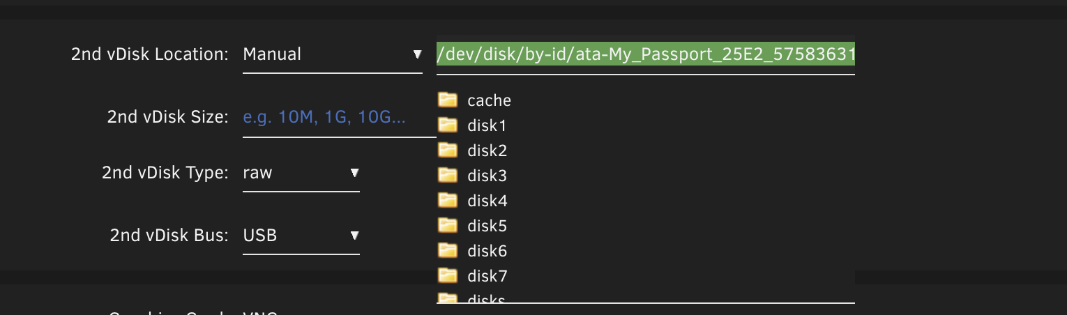

July 23, 20197 yr Hi folks, I've followed spaceinvaders useful guide (8:00 minutes in) but can't figure out why this isn't working for me. When I add the ID and save, it hangs and won't update. any ideas what i'm doing wrong? e.g. /dev/disk/by-id/ata-My_Passport_25E2_57583631413138354B324554
July 23, 20197 yr Author yeah, I can enable passthrough by adding /dev/sdX - this had been my workaround but recently Windows stopped recognising the partition when the drive was re-attached (even after updating /dev/sdX in the 2nd vdisk settings) and it required formatting in diskmgmt every time it was connected
July 23, 20197 yr Author i've also tried different USB drives, can't get any to work with /dev/disk/by-id/
July 23, 20197 yr If I have mounted a drive with unassigned devices I can't hand it over to a VM. Click unmount in unassigned devices and try your passthrough again.

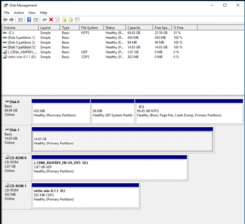

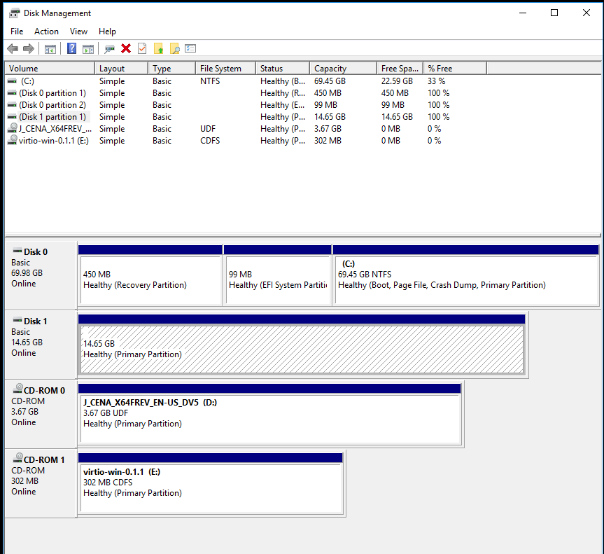

July 23, 20197 yr Author still no luck adding with /dev/disk/by-id/, but mounted or unmounted I can add it to VM using /dev/sdp or /dev/sdp1 but Windows 10 will not show the partition I created the last time it was attached, even unRaid sees the partition 'DB' Windows just shows 'disk1'
July 23, 20197 yr Can you assign a drive letter to that partition in Windows? Rightclick on the partition and select "change drive letter or paths" and choose a letter that isn't in use by any other device or network share.
July 23, 20197 yr Author yes that fixed the issue with the partition not showing - thanks any other ideas about the disk/by-id issue?
