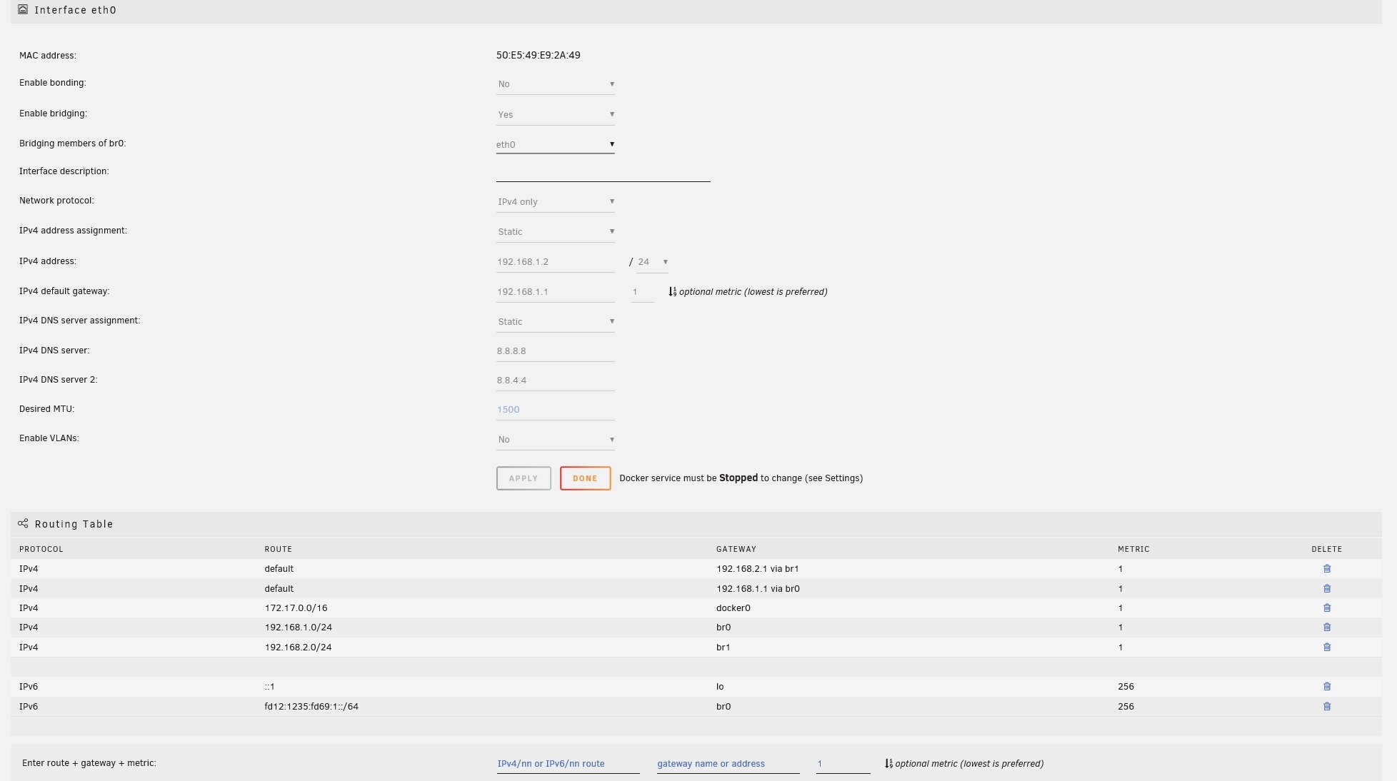

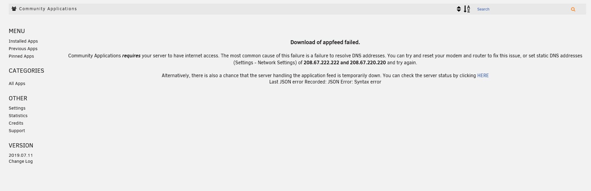

I updated to version 6.7.2 from 6.* (I can't remember the version but I'm a new user so it wasn't all that old) and since doing so I can't access the 'Apps Store'. I used to have another network card attached to my device and I think it's got something to do with the default gateway being set to the old device. I've tried deleting the settings from the GUI but it doesn't want to go.
I attached a couple of screenshots which probably explains a lot more than I can by typing.

You have 2 default routes. There should be only one defined.
Yep, but how do I delete the 192.168.2.1 route?... using the delete icon doesn't do anything.
It is used by the bridge br1. If you don't use it by any docker or VM remove it and you should be able to remove the 192.168.2.1 route or it is removed by removing the bridge. Can't test it right now. You can also find the network config in the config folder on your Unraid flash drive in one of the text files. Make sure you are removing the right bridge.
Ok, I don't use br1 but I also can't remember how I created it or where to delete it... can it be delete it via the GUI?

Click the trashcan should do the trick. At least it did for me as I had that issue upgrading to 6.7.2. This is the corresponding line:
192.168.2.0/24 		br1		1

Trashcan doesn't work for me.
Remove the following part in the textfile. I think you have to restart Unraid to take this changes in place.
