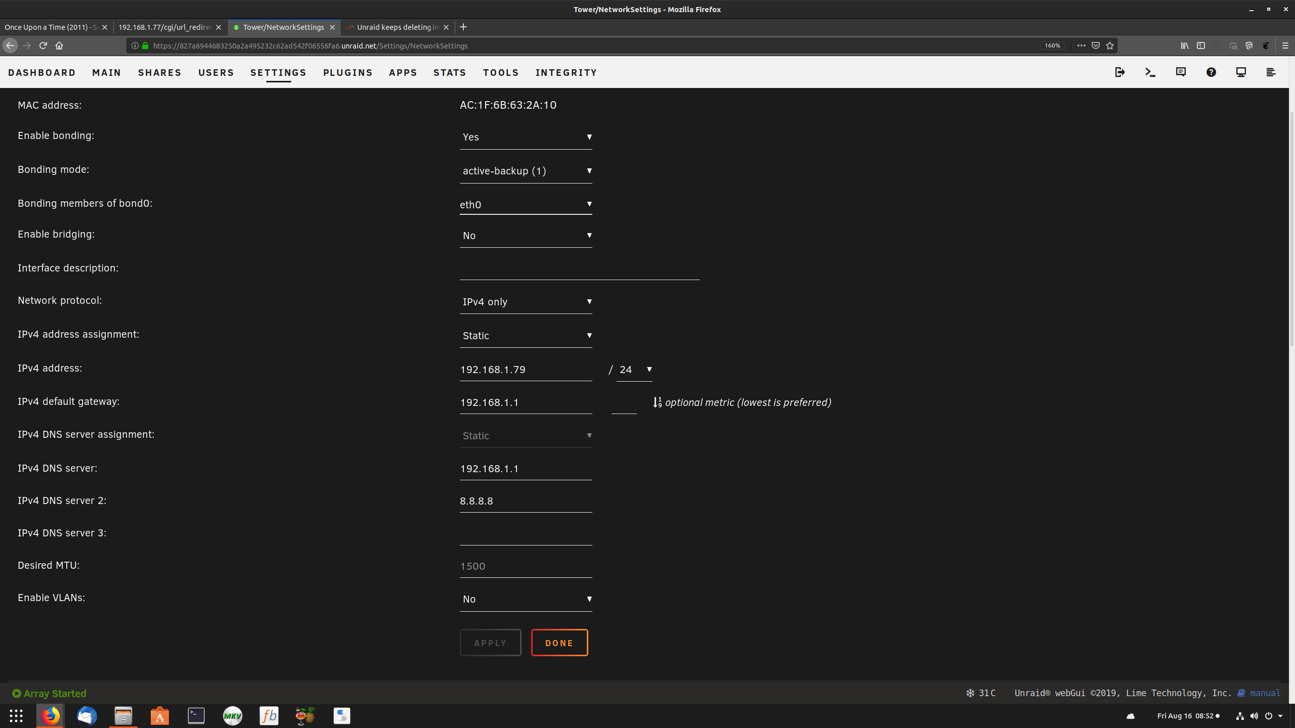

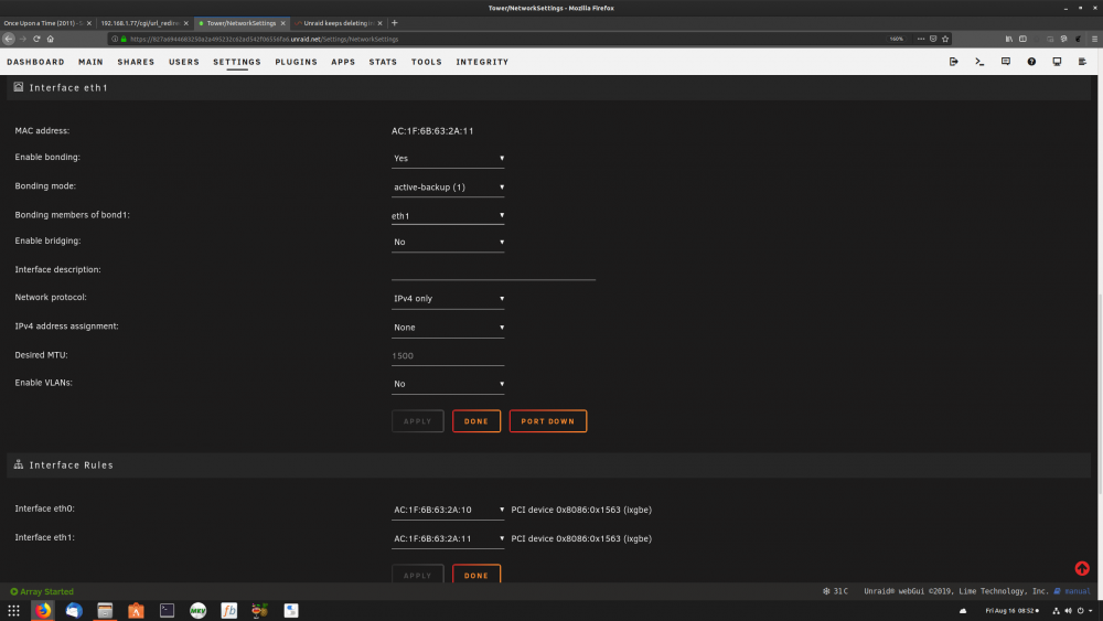

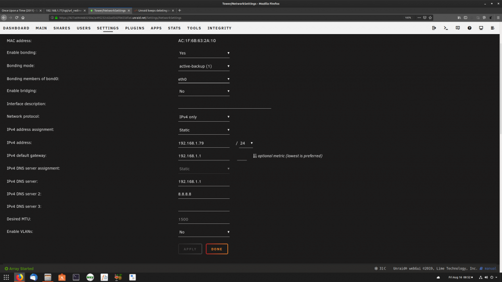

August 16, 20197 yr Author I messed around with my network settings a little and now this is my logs after boot. Aug 16 08:50:01 Tower shfs: stderr redirected to syslog Aug 16 08:50:01 Tower emhttpd: shcmd (99): /usr/local/sbin/update_cron Aug 16 08:50:01 Tower ntpd[1748]: Deleting interface #3 bond0, 192.168.1.79#123, interface stats: received=12, sent=12, dropped=0, active_time=44 secs Aug 16 08:50:01 Tower ntpd[1748]: 66.7.96.1 local addr 192.168.1.79 -> <null> Aug 16 08:50:01 Tower ntpd[1748]: 34.227.158.1 local addr 192.168.1.79 -> <null> Aug 16 08:50:01 Tower ntpd[1748]: Deleting interface #4 bond0, fe80::ae1f:6bff:fe63:2a10%12#123, interface stats: received=0, sent=0, dropped=0, active_time=44 secs Aug 16 08:50:01 Tower root: Delaying execution of fix common problems scan for 10 minutes Aug 16 08:50:01 Tower unassigned.devices: Mounting 'Auto Mount' Devices... Aug 16 08:50:01 Tower emhttpd: Starting services... Aug 16 08:50:01 Tower emhttpd: shcmd (101): /etc/rc.d/rc.samba restart Aug 16 08:50:03 Tower kernel: ixgbe 0000:05:00.0 eth0: NIC Link is Up 1 Gbps, Flow Control: None Aug 16 08:50:03 Tower kernel: bond0: link status definitely up for interface eth0, 1000 Mbps full duplex Aug 16 08:50:03 Tower kernel: bond0: making interface eth0 the new active one Aug 16 08:50:03 Tower kernel: bond0: first active interface up! Aug 16 08:50:03 Tower root: Starting Samba: /usr/sbin/nmbd -D Aug 16 08:50:03 Tower root: /usr/sbin/smbd -D Aug 16 08:50:03 Tower root: /usr/sbin/winbindd -D Aug 16 08:50:03 Tower emhttpd: nothing to sync Aug 16 08:50:03 Tower unassigned.devices: Mounting 'Auto Mount' Remote Shares... Aug 16 08:50:03 Tower sudo: root : TTY=unknown ; PWD=/ ; USER=nobody ; COMMAND=/bin/bash -c /usr/local/emhttp/plugins/unbalance/unbalance -port 6237 Aug 16 08:50:05 Tower ntpd[1748]: Listen normally on 5 bond0 192.168.1.79:123 Aug 16 08:50:05 Tower ntpd[1748]: Listen normally on 6 bond0 [fe80::ae1f:6bff:fe63:2a10%12]:123 Aug 16 08:50:05 Tower ntpd[1748]: new interface(s) found: waking up resolver
