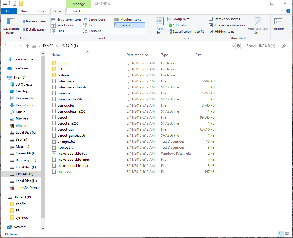

The attached image is the root of my usb drive post console boot

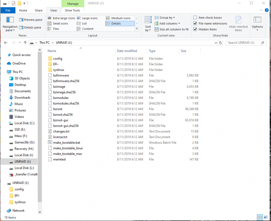

The image shows what I've changed. I switched from Auto Config to USE DHCP Server.

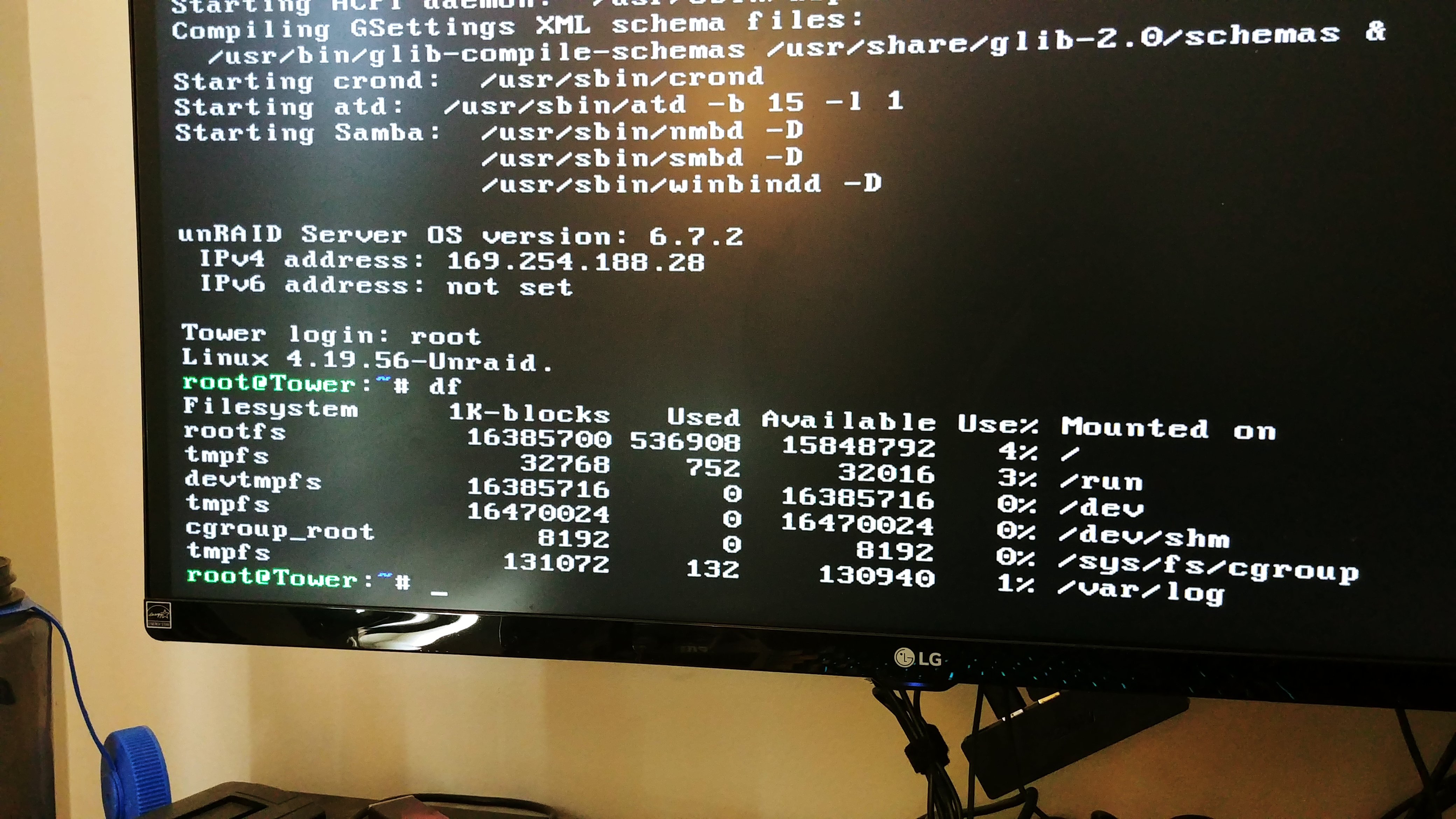

When you boot up can you get to the command line and try the ‘df’ command.    If so is the USB stick mounted as /boot?    If not that would explain your problems are due to the fact that the second stage of the boot process is not completing properly.   If you can use a USB2 port for the USB stick as they seem to be far more reliable during the boot process.

Here's the results of the df command

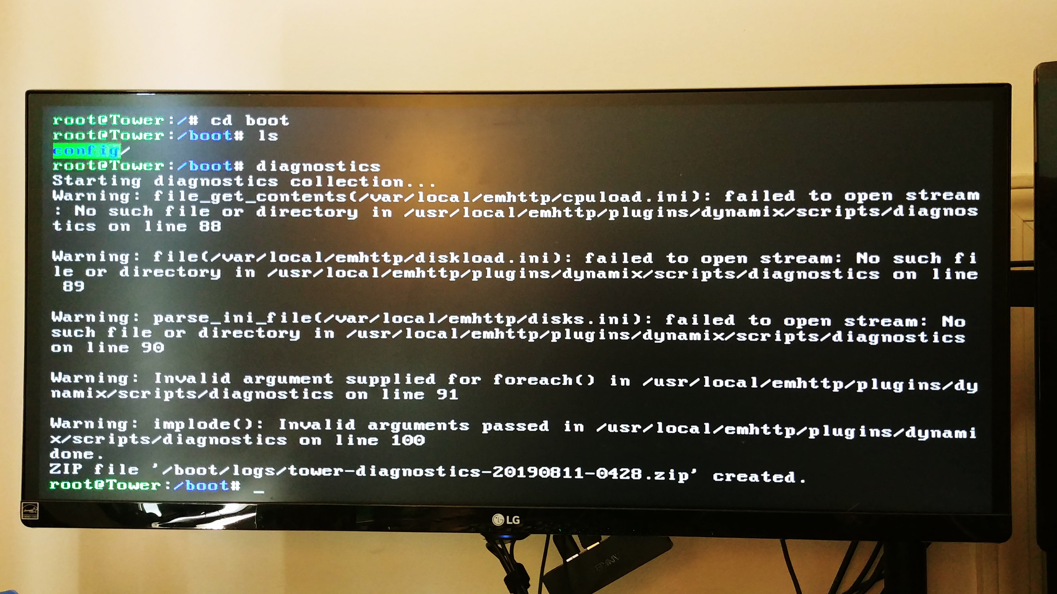

This is what happens when I run diagnostics
If the ‘df’ command does not show /boot then the second phase of the Unraid boot process where it tries to run items using the USB device has failed.    This also means that any attempt to run the ‘diagnostics’ command will fail as that assumes /boot is mounted.   It also means that no network will be started and the Unraid GUI will not be run.
the problem is going to be to identify why Unraid is not seeing the USB stick after booting the Linux kernel.   One thing that has helped some people is to use a different machine to create the USB stick used for booting Unraid.    It can also be worth checking that the USB stick can be booted on another system if you can.   Trying a different USB stick is another option.
