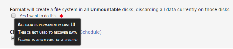

See the screenshot above.
I'm sorry, but I don't understand what you are referring to. I never formatted the old drive. I formatted the new drive before adding it to the array and starting the rebuild. I don't see how that is relevant.
Please help me understand.
Your formatted the emulated disk, formatting deletes all data and updates parity accordingly, then you rebuilt an empty disk.
