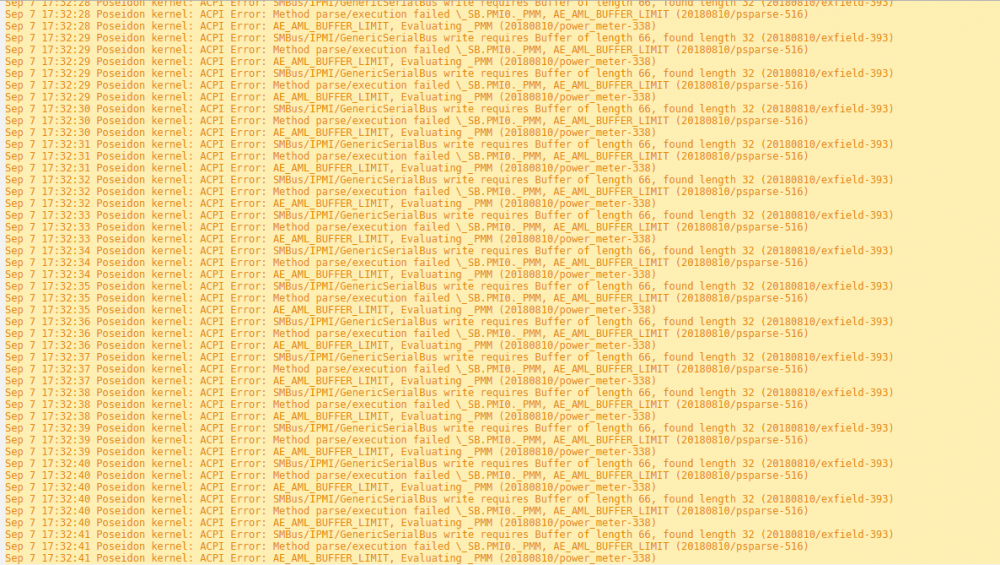

(help) log is filling up
im not sure what is suddenly causing this, i have yet to find anyone with the same issue as this, i hope someone can help me shed some light on it. i did not post the whole log only a screen shot if someone needs the whole log, i will post it "if instructed how to do so" thanks in advance!

im not sure if its actually fixed.. seeing how my server is actually a HP ML350 G6 not a gen8.. but i added this as recommended in the thread here:
https://forums.unraid.net/topic/59375-hp-proliant-workstation-unraid-information-thread/
and the log is now back to normal, i hope someone can chime in if this is a sufficient fix for my situation as i hope im not just masking the issue.. once i know this is fine i will change the title to (solved)
thanks in advance!
