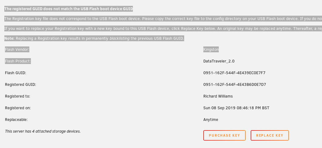

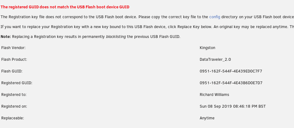

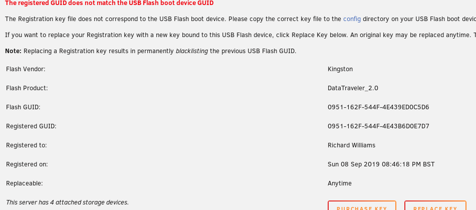

Bit of a strange one. I bought a license and applied it however despite not changing the flash drive the GUID has changed when powering down the array to add a drive and therefore is not licensed. Any ideas? Its a Kingston data traveller 2.0. Hardware is a Dell t5500
Ive attached screenshots to show the ID changing after a power down.

If that flash won't report a consistent GUID you'll have to replace with one that will.
