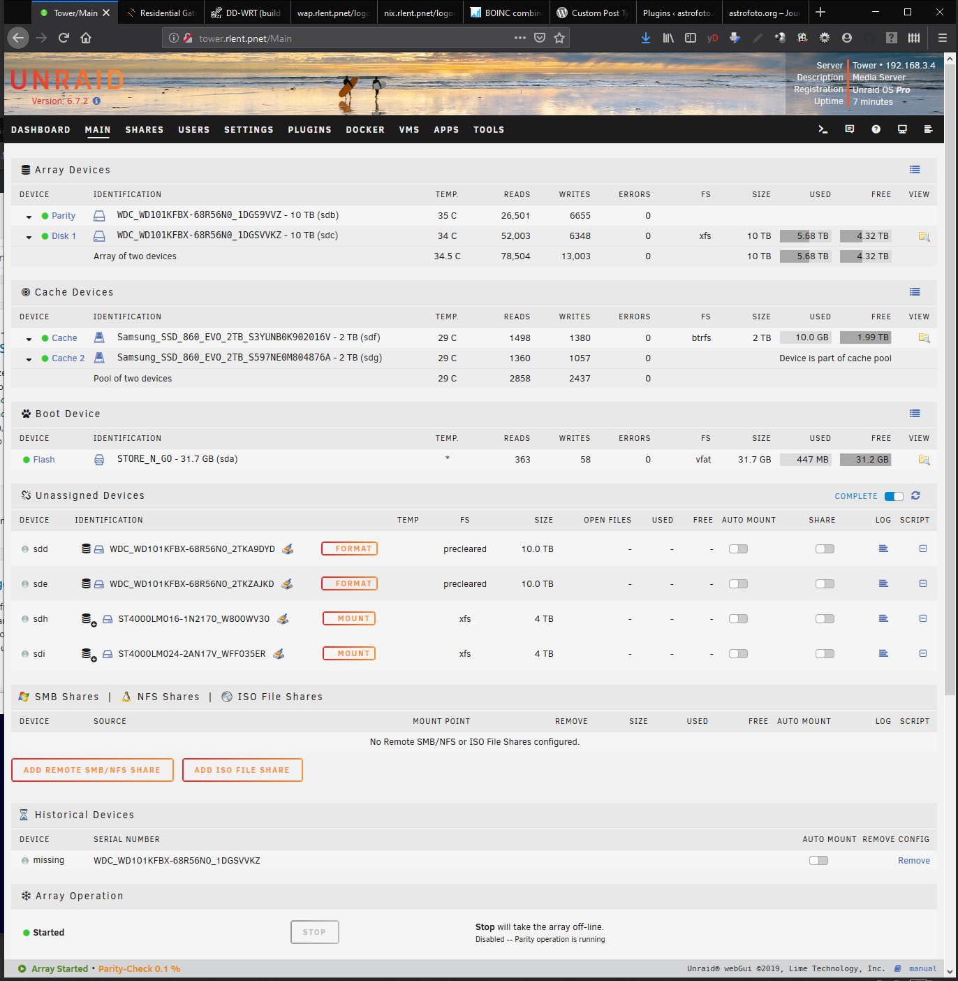

September 30, 20197 yr I have a device which is appearing in the "Historical Devices" section as missing, but it's the same identification as an active array device. I'm not quite sure how to clear this and if I can just safely hit the "Remove Config" link on the Main tab. Unraid 6.7.2 Supermicro X9DAi 2 x XEON E5-2695v2 128 GB Memory 2 x WDC WD101KFBX 10 TB Array 2 x Samsung 860 EVO 2 TB Cache
September 30, 20197 yr It's probably because you had the disk in UD and then put it in the array. Please show a screen shot and post diagnostics.

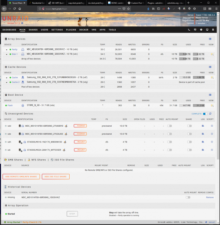

September 30, 20197 yr Author Screenshot and diagnostics attached. I also just had an error pop up with a corrupt flash, the screenshot and diagnostics are from after the recovery from that. Unfortunately, I didn't have a recent backup of the flash where I was sure that super.dat was up-to-date, so the array thinks it was shut down dirty and is now doing a parity check. tower-diagnostics-20190930-1627.zip Edited September 30, 20197 yr by rbroberts
September 30, 20197 yr 3 hours ago, rbroberts said: Screenshot and diagnostics attached. I also just had an error pop up with a corrupt flash, the screenshot and diagnostics are from after the recovery from that. Unfortunately, I didn't have a recent backup of the flash where I was sure that super.dat was up-to-date, so the array thinks it was shut down dirty and is now doing a parity check. tower-diagnostics-20190930-1627.zip 126.53 kB · 0 downloads Just remove the historical device.
