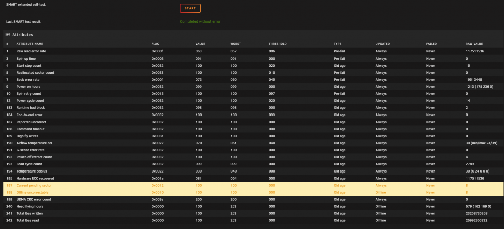

got an alert that there are errors on my parity drive.
i ran the smart extended self-test and it came up with no errors. though the two highlighted in attached image have me a bit concerned. But i'm not sure if it was just a fluke - can i 'clear' the error to see if it pops up again? or is that ill-advised?
You can't clear those errors. I had same happen to me and the drive eventually failed. If you get anymore I would suggest to replace the drive.

oh boy. jeez, this will be the 4th seagate drive failure :/ i guess i'll move the rest over to wd and get to blocking pins. Thanks for the heads up!
Mine was also a Seagate drive, I have not had very good luck with Seagate drives either.
