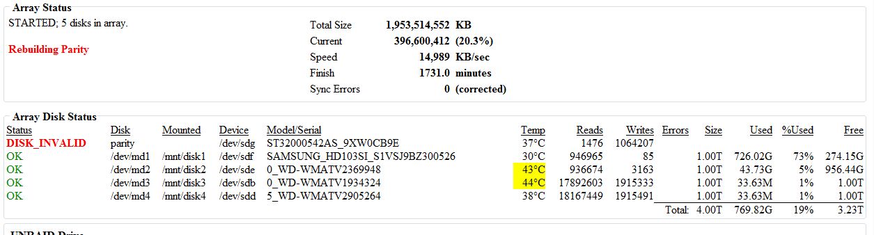

i have posted a screenshot which i hope helps explain what i am about to say.
i had a working system with three drives in it 1 parity (which is definitely still the same as it's my only 2TB drive),my 2 data drives where /dev/md1 and dev/md3 and /dev/md2 was empty, so i read the article and thought i could make the change and ended up with /dev/md1 in the same place and moving /dev/md3 to /dev/md2 and /dev/md3 and /dev/md4 added as new drives and formatted and now the parity build is still going on....
i have attached the syslog file.. please help Joe L. you are my only hope... (not too cheesy i hope)
just for info sake i have not rebooted at all since the change.
i hope i have answered sensibly
sorry had to zip the syslog no space for attachement
I can see in the syslog the actions you took.  It does not look like you did anything really that unusual.
The actions you took were identical to those if you had just started up the array with existing drives.
From what I can see disk3 and disk4 were just added and formatted.  Those are the new disks?

Has the parity calculation completed?  (should be close by now if not finished)

Array StatusSTARTED; 5 disks in array.
Rebuilding Parity Total Size 1,953,514,552  KB
Current 608,127,044  (31.1%)
Speed 15,132  KB/sec
Finish 1481.6  minutes
Sync Errors 0  (corrected)
as of 1 minute ago
still a while before finished so can i MAYBE have some hope that the parity build COULD fix it ?
should i let the parity build finish??

Parity is NOT going to fix it.  You are currently reading the data disks and WRITING to the parity disk.  Therefore, parity, once completed will reflect the current contents of the disks.  Forthermore, it was valid ONLY for the prior disk configuration... with three disks.  By adding the two additional disks it was no longer valid.  It is why it now needs to be re-calculated.
By typing "initconfig" you specifically asked unRAID to completely forget its old parity information and immediately invalidate it.

** messages  (including version),  the reiserfsck logfile, **
** check  the  syslog file  for  any  related information. **
** If you would like advice on using this program, support **
** is available  for $25 at  www.namesys.com/support.html. **
Will rebuild the filesystem (/dev/md1) tree
Will put log info to 'stdout'
Do you want to run this program?[N/Yes] (note need to type Yes if you do):Yes
Replaying journal: Done.
Reiserfs journal '/dev/md1' in blocks [18..8211]: 0 transactions replayed
reiserfsck --rebuild-tree started at Sun Nov 14 22:30:16 2010
Pass 0:
####### Pass 0 #######
The whole partition (244190374 blocks) is to be scanned
Skipping 15663 blocks (super block, journal, bitmaps) 244174711 blocks will be read
0%....                                                  left 130875138, 4607 /seccc
A disk cannot un-mount if it is "busy"
A disk is busy if a file on it is open for reading or writing.
A disk is busy if it is the current directory for a program.
If you change directory to /mnt/disk1, it therefore makes disk1 busy.  It cannot be un-mounted.
Good luck with your search for your files.
First let me say thank you VERY VERY much for all your help Joe.
But all is lost i'm afraid it managed to find the movies but not 1 photo... weird...
So be it... my stupidity  ??? not unRAID's so i take this as a lesson learned and onto the next
you might try this command and see if they are somewhere you did not look:
find /mnt -type f -iname *.jpg -print
