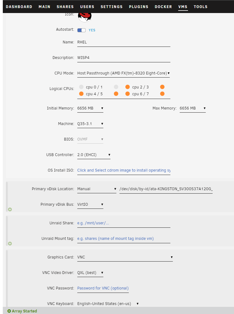

I used the raw disk. Here's my VM configuration. The disk path is the disk itself, not a partition.
I believe OVMF is UEFI only, right? So the VM must be using UEFI.
That does sound likely, that it's some UEFI/legacy BIOS issue, but my motherboard supports UEFI, in fact I boot the UnRAID USB in UEFI mode. Yet it won't boot the disk.

I do see you are using the raw disk (or at least, think you are, the node is cut off) It's possible to treat the first partition of a disk as the disk with VirtIO and then you end up with a disk image stored as a partition.
