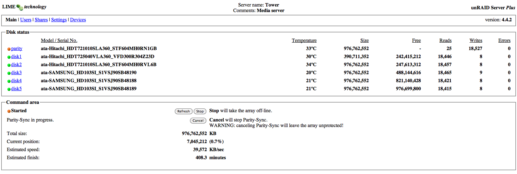

Although my server has been running for well over a year without problems (until recently), I'm still a noob at Unraid and not tremendously technical.
The current problem is that the server freezes about 30 minutes into rebuilding the parity drive (usually around 7% complete). At this point, it won't respond to anything, including not letting me type anything into the command line. I can't get to the syslog at that point, so I've attached the syslog that matches the screen grab.
I ran a memtest and found an error, which I was sure was the problem. But the current memory (1 stick of 512MB) tests fine - I'm sure it's not the memory. I'm also pretty sure the system is not overheating. If it came to it, I could change the processor (I have a spare lying around).
Is there any chance one of you kind folks could have a quick skim through the syslog attached and perhaps make some suggestions as to how I can get this server going again?
